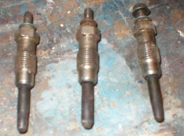

          jim this is the little buggers
          [size=5][/size]
            great ian, pics at this crack are always a big
            (now you can stick them back in your surf )
