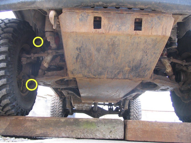

          Did the back of the prop shaft, the two at the front but need to move the truck to do A,B,C,C,C. There are no blancking screws on the hubs, just tapped holes. Thats not good is it?
            the ones in the circles are to the ball joints not the hubs. if they are the ones you mean then no just having open holes is not good. probably got joints full of $$$$.
