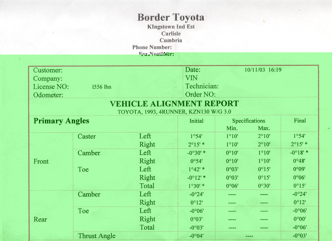

I desperatly need to know the correct tracking for my Surf 3 litre it has BF Goodridge 10.5 x 31 x 15 tyres on 7 x 15 wheels and has worn the inner edge on the drivers side. I was told a measurment a few weeks ago but was not told is in toeing in or out ? If any body can give me the correct setting ASAP i would be ver gratefull.
