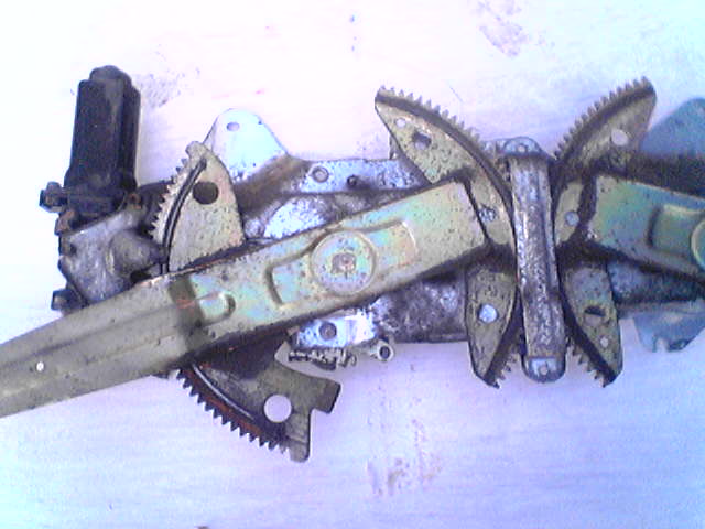

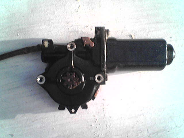

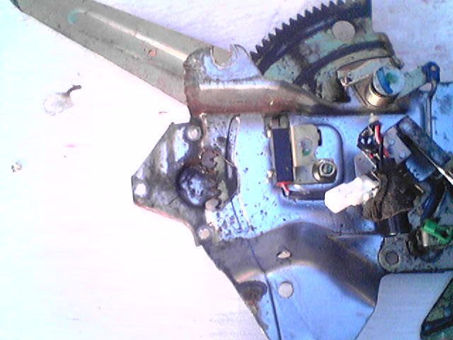

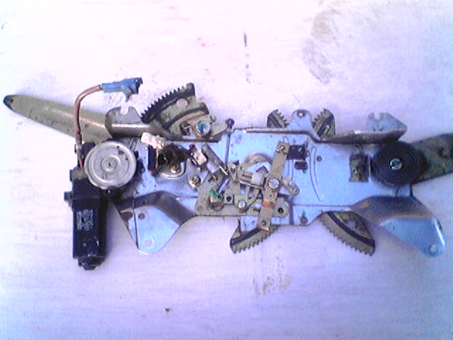

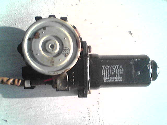

however, I have done search and people speak of 3 M8 bolts/nuts holding motor unit onto regulator - I cant see any on mine!
motor has 2 screws clamping it to assembly, but looks like whole regulator has to come out to undo them, as they are aligned parallel to the window...
anyone got any pics?
Unplug the power connector. Undo the three bolts from the underside with an 8mm ring spanner. It is a bit fiddly. I managed it with hands like bunches of bananas.
