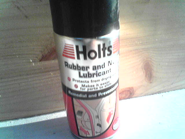

For your rear window, get yourself some of this and spray in the channels where the glass touches, including accross the top.....
