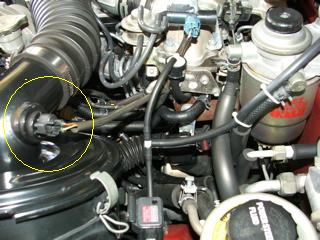

    My turbo light does not come on but the check light is on, any ideas please

      Check that your air temp. sensor is plugged in.............

          At bottom centre of the above pic is the Turbo Pressure Sensor. Check the hose for this is connected. It runs from under throttle body to the white filter and then to the sensor. Very common for this hose to fall off because of deterioration or even have a hole or be split.
