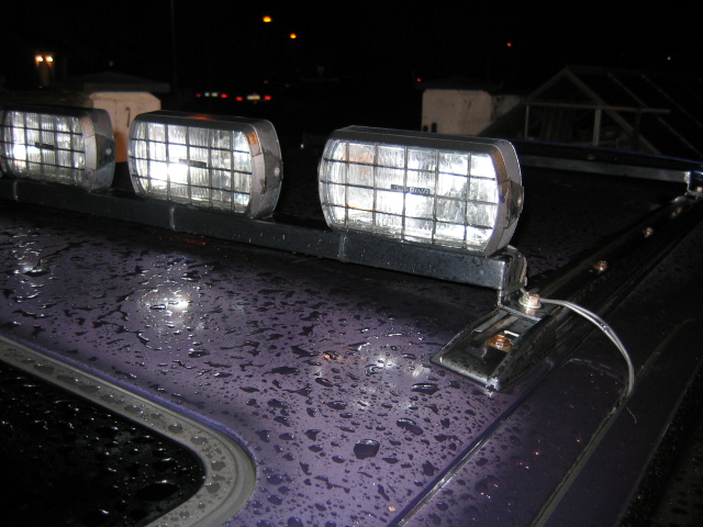

    I've recently bought a nice set of 4 spots and intended on mounting them on a singe bar on the roof...BUT... after searching high and low I can't find one that will fit or one that I can make fit.
    My motor came with some slides that fit in the roof runs but onlv seem to be able to be used for strapping down. The roof rails start to the rear of the back doors and that seems a little far back for my liking.
    Does anyone know where I can obtain a roof bar that will seat nearer to the front or at least if I could 'modity' one easily. By the way its a 3rd gen and getting parts is a nightmare. cheer surfers

      Pic quality is not the best but its dark and raining outside!!!!
      But you should get the idea.

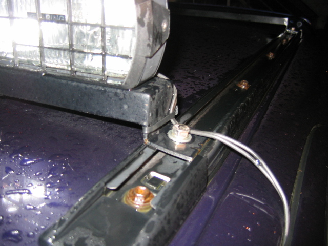

        made them myself from some box tubing and some angle iron. just welded the angle iron onto the box and then bent the angle iron to suit the roof rails. then cut a piece of flat and drilled and tapped it, put it into the roof rail and bolted through the angle iron into the piece of flat.
        better pics tomorrow if needed!!
