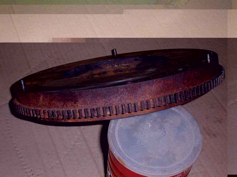

    Does anyone know anything about disintegrating flywheels? I just bought some stuff from Milner and their catalogue seems to indicate that the flywheel is prone to dropping to pieces! What's the story?

      Surfs built after 1991 (the sad EFI ones) have a "Dual Mass Flywheel" which is in 2 sections with springs and fiction material between them like a conventional clutch.
      When you change the clutch you're supposed to have the flywheel serviced too, which of course no one ever does. The flywheel never actually comes apart, it just behaves the way that an ordinary clutch with weak springs would.
