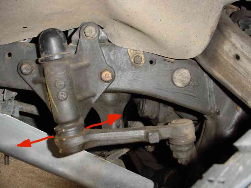

          If worn there will be movement as shown by the arrows in the photo. Jack the front passeneger side, grab the sides of the wheel and try and move from side to side. Any wear will show up as movement. The plastic bushes inside the arm can be replaced but as often as not the steel rod in the middle has rusted away so the whole arm needs replacing. Milners sell both items- but I think I have a spare set of plastic bushes if you need them?

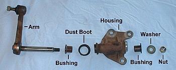

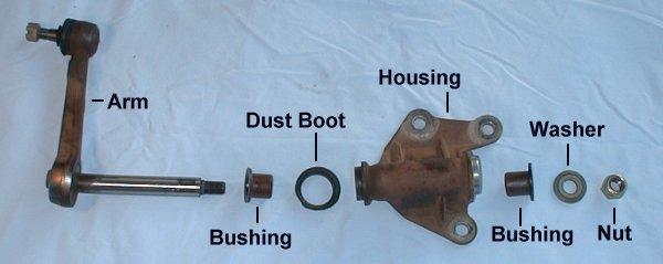

            Heres a breakdown of the bits.
