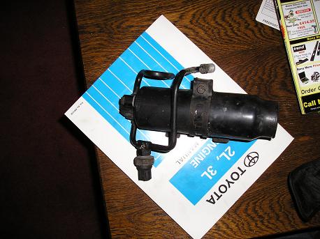

on the 2.4 it on the cylinder mounted in front of the radiator bout the size of a beer tin, sight glass in the top. you know the one. i had just cut one off my truck if you need one. my grandparents lived on th island... is it still er.. a bit quiet..?it's in me shed, mate.
ITS GETTING NOISY NOW LOOKED AT CYLINDER CAN'T SEE IT THERE IS IT IN FRONT OR ON BACK OF DRYER.Originally posted by Chillitton the 2.4 it on the cylinder mounted in front of the radiator bout the size of a beer tin, sight glass in the top. you know the one. i had just cut one off my truck if you need one. my grandparents lived on th island... is it still er.. a bit quiet..?
