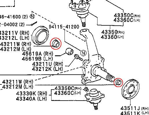

      i'll ask again - can anyone tell me where to find detailed instructions for carrying out this repair. That one diagram that keeps getting posted may be of use to the more experienced mechanic, but to me its useless.

        OK...
        Put front on axle stands and remove wheel,
        Undo bolts on inner CV (tight as F***)
        Remove lower shock bolt, and pull shock out of way.
        Remove dome cover from end of drive plate, and bolt under it.
        Remove drive plate (round disc on end of hub 6xnuts and washers)
        Remove circlip on stub shaft
        Pull inner CV off studs and pull drive shaft back through hub. (need to put a jack under lower ball joint, and jack the wishbones up to get shaft to get it out or it won't clear the bottom wishbone.
        Then you can drift out the old bushes, one from each end of the hub.
        Check CV boots while driveshaft is out and replace if cracking, to save time later.
        Reassemble, crack open tinny and relax.
        Or, alternativily, pay me to do it!
        **EDIT, just noticed you have a 3rd gen! Disregard all the above, it don't work, you don't have the bushes. The wheel bearing supports the hub, and the driveshaft goes straight in to that. Look somewhere else for you noise.

                  worn bushes
                  Can anyone tell me evactly what the bushes are called that I have to ask for and where I c\an order them from, as my missus is in the uk next week so I can get them delivered to a mates address an she can bring them back to spain,

                      Well, just fitted the bushes and........... it's all nice and quiet...... almost! The rattle from the drivers side has gone, completely, but I think I' might need another pair for the N/S..... we'll see.
                      As long as we have the part No's, don't s'ppose it matters what they're called?

                        Glad they worked Ok Damian. Shame about the other side. Yes, the part numbers are the same both sides.
