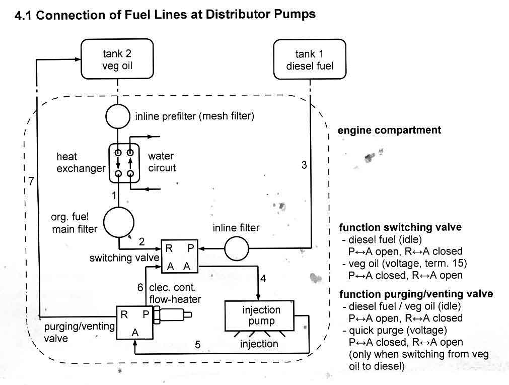

    I've reached the stage now where I have to decide which type of fuel pump I have. The fitting instructions give me the choice of either having a Distributor or Inline Fuel Pump.
    Please could someone teach me the difference and enlighten me as to what my Surf is fitted with. I've got the our Forum, Haynes manual, the Mitchels online manuals and access to Toyota manual. None of them explicitly state what type of pump it is.
    Deduction has lead me to the conclusion that it's an inline pump , but I'm not confident enough to start slicing through fuel lines yet!!

    Its a distributive type pump in the 3.0 1KZ-TE engine.
    Out of curiosity, is there much difference in the fitting of the kit pending the type of pump found ? (I've never dealt with an inline type)

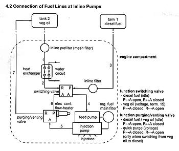

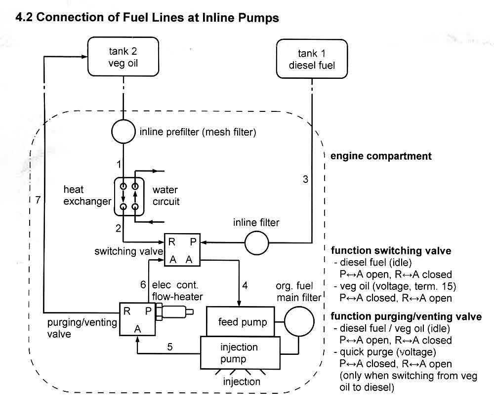

    The differences seem to be to do with the positioning of the fuel filters. Here are scans of the different flow diagrams for the two different fuel pumps.
