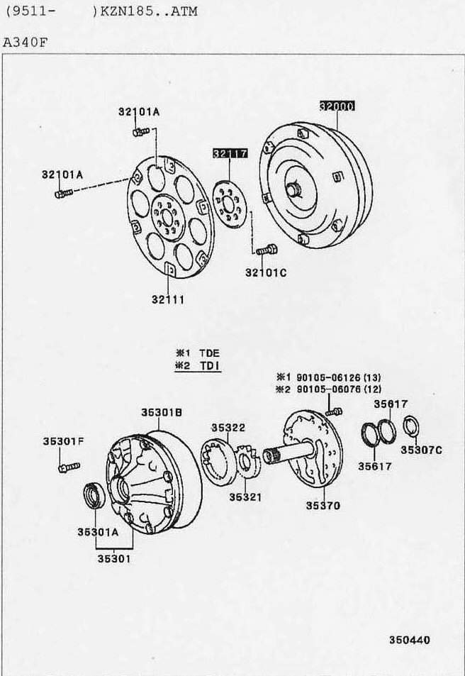

        I've ordered the part 35301A (front oil seal) from Toyo, arriving from Belgium next Thursday (£9.00)
        Looking at the diagram it looks like the seal locates at the front of the casting and the shaft is splined from the front meaning the plate can be removed in situ ?? Then the new seal pressed into place.
        I dont want to start this job then find the torque convertor need taking apart as I need the car next week to get to Manchester Airport for some much needed R+R.
        Any thoughts ??????
          Mate, I'd be tempted to leave the housing in-situ if you can, and hook the seal out on its own with a couple of L shaped small bars in 2 little holes you can punch in the oil seal.
          But if not, it looks to come off OK, but I'd try not to disturb the stuff behind it when pulling the cover off if poss.
