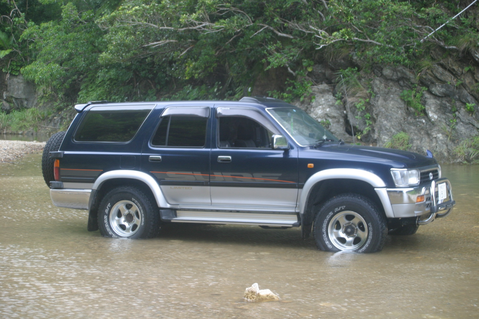

I have heard that mineral-based and synthetic oils do not mix well and that switching to a synthetic oil requires a thorough flush-out of the component (crankcase, transfer case, or differential) so that damage will not occur due to limited lubrication as a result of the mixing of the two types of oils.
To what extent, beyond a drain plug removal and complete drip-draining, should these components be emptied of the factory oils prior to filling with synthetic lubricants? I once upgraded to a synthetic differential fluid in a one-ton two-wheel-drive truck; I recall draining the gear fluid via the drain plug, removing the differential cover, and with turkey baster and catch pan in hand completely flushing all remaining factory differential oil from the differential. I cannot, however, remember what fluid I was using to clean out the gear housing.
Also, is a synthetic automatic transmission fluid available? In my effort to keep my Surf running well for many years (and kilometers) to come I am planning a five-box synthetic fluid upgrade.
Thanks to anyone who may offer advice. I check the posts on this site often and find the information both informative and interesting.
