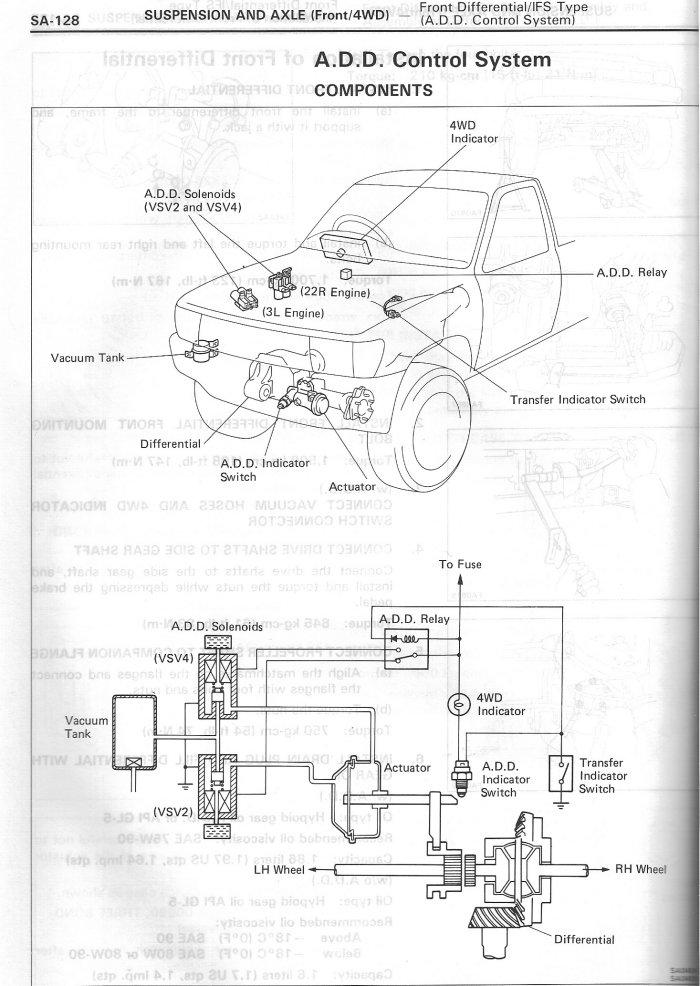

has anyone ever repalced a vacum hose for the 4wd transmission? the only ones in the search relate to other things.
it is to do with my 4wd not engaging the front axle. in a previous thread someone suggested that this may be my problem. i have also sopken to a mechanic that says he worked on a pajero that had the same problem and it turned out it just needed a new hose to the front axle diff.
this sounds like a really easy job as by my reckoning, you just plug a bit of pipe in at either end.
my haynes mentions nothing of it.
...i dont have a clue what a vacum hose is or what it does but if its simple for ANYBODY WITH NO KNOWLEDGE to do then ill give it ago.
