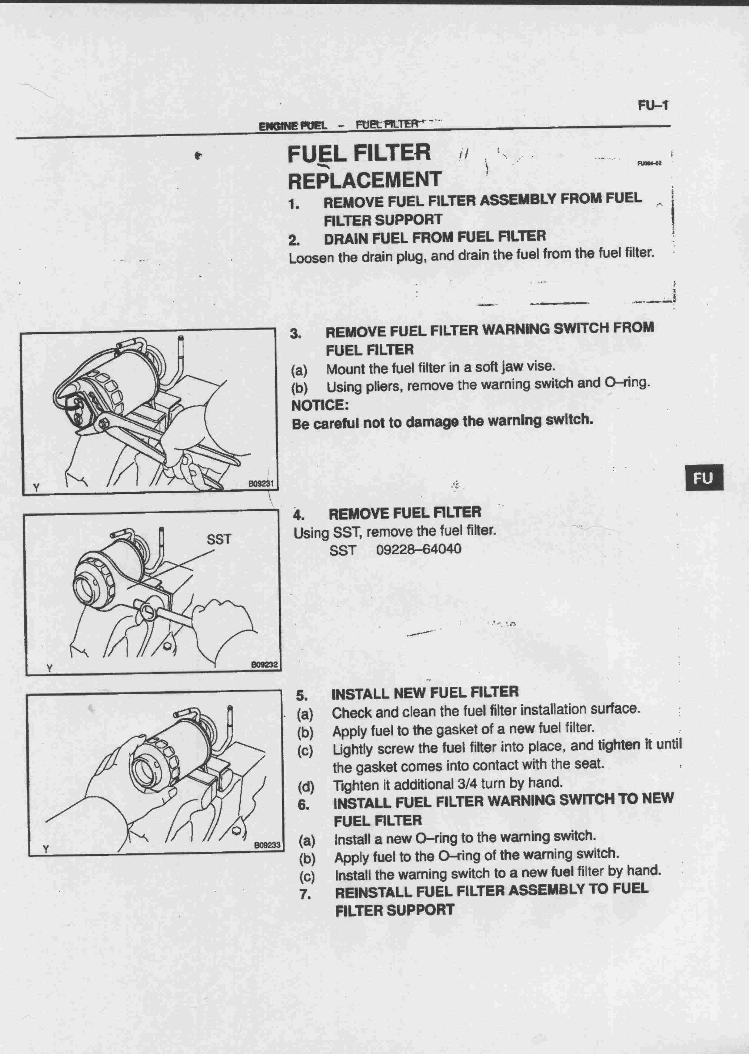

Well i am chicken to change the fuel filter and want to try so can anyone tell me how to go about as detailed as possible .
cheers damian
