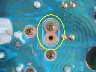

As your is a '96, it should be a 3rd Gen model (lift up tailgate) to reset the light you will need to remove the clocks, on the rear is a location with 2 screw holes about an inch apart, with a screw in only one of them. To reset the light you must remove the screw and place it in the alternate hole.Originally posted by safetymanMany thanks Codlord. My surf is a 1996 SSRX 3.0. The dash looks the same as the picture. I didn't know if there was a reset button or code that needed to be entered. I only just put the dash back together after changing my speedo face.

Have a search here on the forum and you should find a photo of the screw its and alternate position.Maurice
