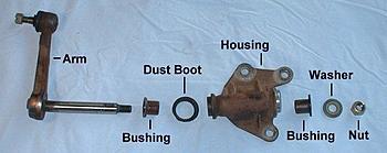

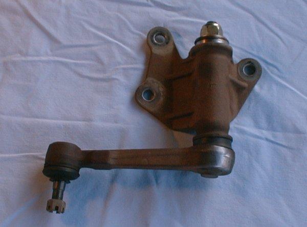

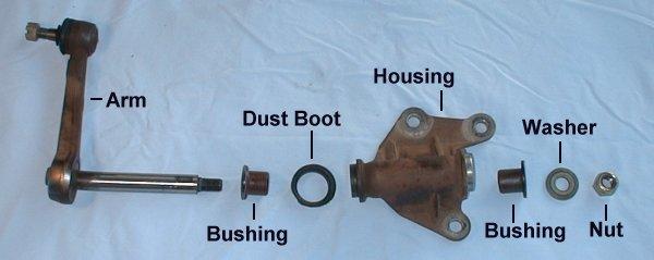

Bit of a co-incidence this - i have a bit of play in the idler arm & have just got new bushes from Roughtrax - £5.88p. Not got round to doing it yet but looks a doddle to do, so please correct me if i'm wrong....
1. crack off the steering ball joint with an appropriate splitter.
2. Remove the idler arm - 3 bolts.
3. Prise off the top cover, remove the nut & the arm should drop out of the housing.
4. replace bushes, grease up & stick it all back together.
If anyone's done this job & there's anything else, please let me know.
Cheers....
Check the shaft itself for wear and also straightness.They have been known to bend and this will destroy new bushes fairly quickly.Originally posted by mikeyBit of a co-incidence this - i have a bit of play in the idler arm & have just got new bushes from Roughtrax - £5.88p. Not got round to doing it yet but looks a doddle to do, so please correct me if i'm wrong....
