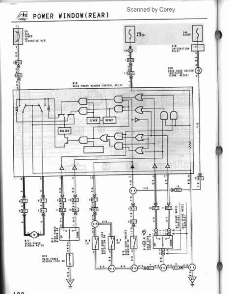

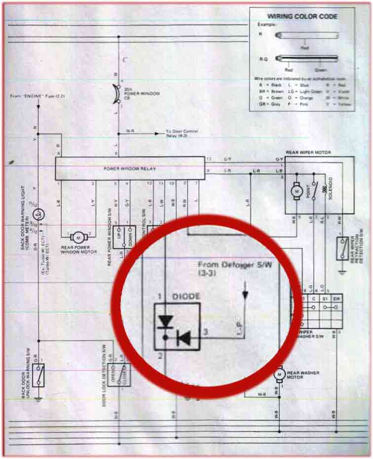

Superb Forum but this time I need to ask a question . My 1993 2.4 has a serious problem or it could soon become one . my rear heated screen does not work yet all other back door features are fine so I removed the rear door pannel and had a look inside . To my horror I found that a white and black wire has melted along the harness and chased it back to a terminal behind the near side rear trim panel . There should be a small black item here that when connected goes back to the cars main wiring however since it has melted I do not know what it was . Any ideas ? I think that it could be a Diode . My Heated Rear Screen switch does not light up at all . ( Not Surpriced ) Any real help would be appreciated .
