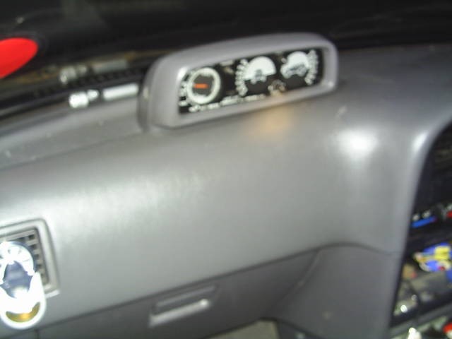

Have removed lower passenger side dash and glove box. Hung upside down for a bit and think I may have found the connector on the main loom. Need to electrical test it to see if it is sidelight operated. Can't see where to mount it yet as there is a heater duct that runs under dashboard and obscures any view of where factory mounting points might be.
Would really appreciate any pictures anyone has taken of a factory fitted one on their dashboard and the loom connection. If not, anyone taken off the upper passenger side dash ?. Lots of instructions available for drivers side but can't find anything for passenger side.

Mine is as pic- sorry slightly blurry havent got used to close work on camera, was cold aswell!
Nearside trim:
10mm bolt on far left next to door opening, low down.
Bottom of glove box, 1x cross head screw each side of flap.
Open glovebox, 3x cross head screws along top edge.
I moved the lower centre trim (on carpet) by using a small screwdriver to push in either side, grey circular clip centre.
Top edge of this trim just snaps in and out.
Lift out lower centre trim, then glovebox (id close it as it comes free if its anything like mine!)
My clinometer has a x head screw either side, undoing them releases the meter(i think), and leaves the brackets exposed.
Disconnect wire from sidelights and thats it.
Hope this helps
