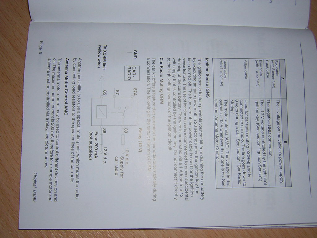

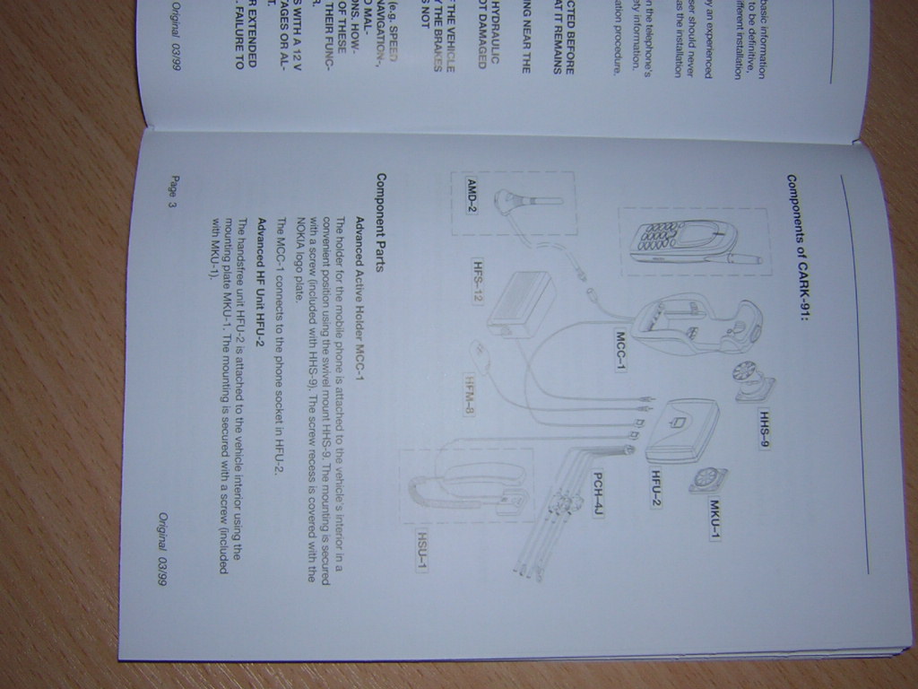

Just got a nokia Cark 91 handsfree kit from ebay and have queries as to how to fit the electrics.
The Lux has the Orig Stereo / head unit and so first Q is has it got a mute function for the yellow wire of the handsfree power unit ? if not how does one sort it out so that the stereo mutes on incoming call ?
Also for the ignition sense, is it sufficient to connect to a 12 V on the stereo head unit or must it be from the ignition barrel ?
The handsfree i rceived has 2 sets of block connectors. one having marked wires for rear left front left etc but perhaps its from the old car it was fitted to ?
Any help greatfully recieved !
cheers.
Ron.
