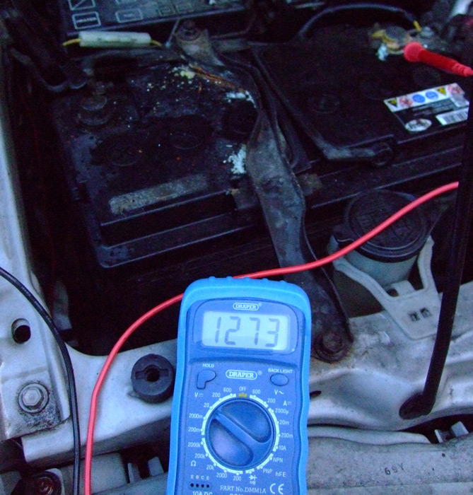

    Checked the battery and it shows a charge of 12.7v. Put it on charge for 8 hours just in case.

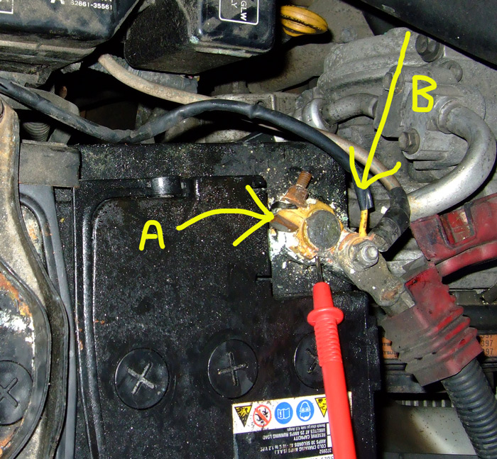

    Also noticed that one of the cables attached to the positive terminal had corroded and broken off. Stripped it back and clamped it under a different bolt on the positive terminal as the bolt it was connected with had stuck solid.
    "A" is where the cable was initially connected, "B" is where it is now.

    What happens to the voltage when you try to start it?

    That level of corrosion around the pillar seal would be indicative of a battery near/at the end of it's life. Can you see the date codes on it?

      First of all, shame on you for letting your battery terminals get in that condition.

      Second, what voltage is the battery now after the charge?

        The voltage is ...12.57v

            I'd start by removing and cleaning those terminals, both + and -, then follow the -ve cable and ensure the other end has a rust free connection.
            That may be all it needs....
            Though at 7 years old it's potentially past it anyway (8 year life is about the lot on a good battery brand).
            With 6 cells, a '12v' battery at 2.2v per cell should be producing 13.2v when not charging (13.5v - 14v charging).

                      Remove both terminal connections before charging, then check the voltage in the morning before re-connecting.
                      There could be a problem with the alternator and by removing the positive cable, it will isolate it.

                          Yes, if there's a problem with the alternator (diode pack? voltage regulator?)the charge won't be going into the battery properly.
                          Just a normal M6 nut and bolt is all you need, or a new clamp from Halfords or similar.
                            As already stated, you need to get behind BOTH terminals & clean them up...that should be your first port of call.
                            Problems associated with poor battery connection usually confine themselves to the earth, however, live terminals can sometimes cause the odd issue too.
                            As Vince pointed out, all you need is an M6 nut/bolt, if the original shears then replace it & if not then all is good.....remove all furring with an abrasive, such as scotchbrite or the likes (careful not to get the stuff in your eyes), then smooth a little Vaseline (petroleum Spirit) over both terminals - this will protect from further oxidisation.
                            If the battery is acid, make sure that there's enough electrolyte in all cells & inspect the plates to ensure they have not corroded/separated - if it's a Gel there should be a Red/Green indicator to let you know the battery state....if after charge the indicator remains red, it's usually a sign to replace.
                            Glass-Gel batteries are a completely different kettle of fish, these batteries can only be trickle charged (0.5 amp over a greater period of time), preferably by an optimiser - once these batteries go flat they rarely ever fully recover, if at all.
                            In all cases you seriously need to avoid spills, even the vapour will destroy a good pair of jeans.

                              Buy new battery clamps. Check fluid level in battery and recharge. Fit new clamps and battery and check/clean all other onnections. Try to start with multimeter connected to battery. If voltage dops below 10V while attempting to start, get a new battery.
