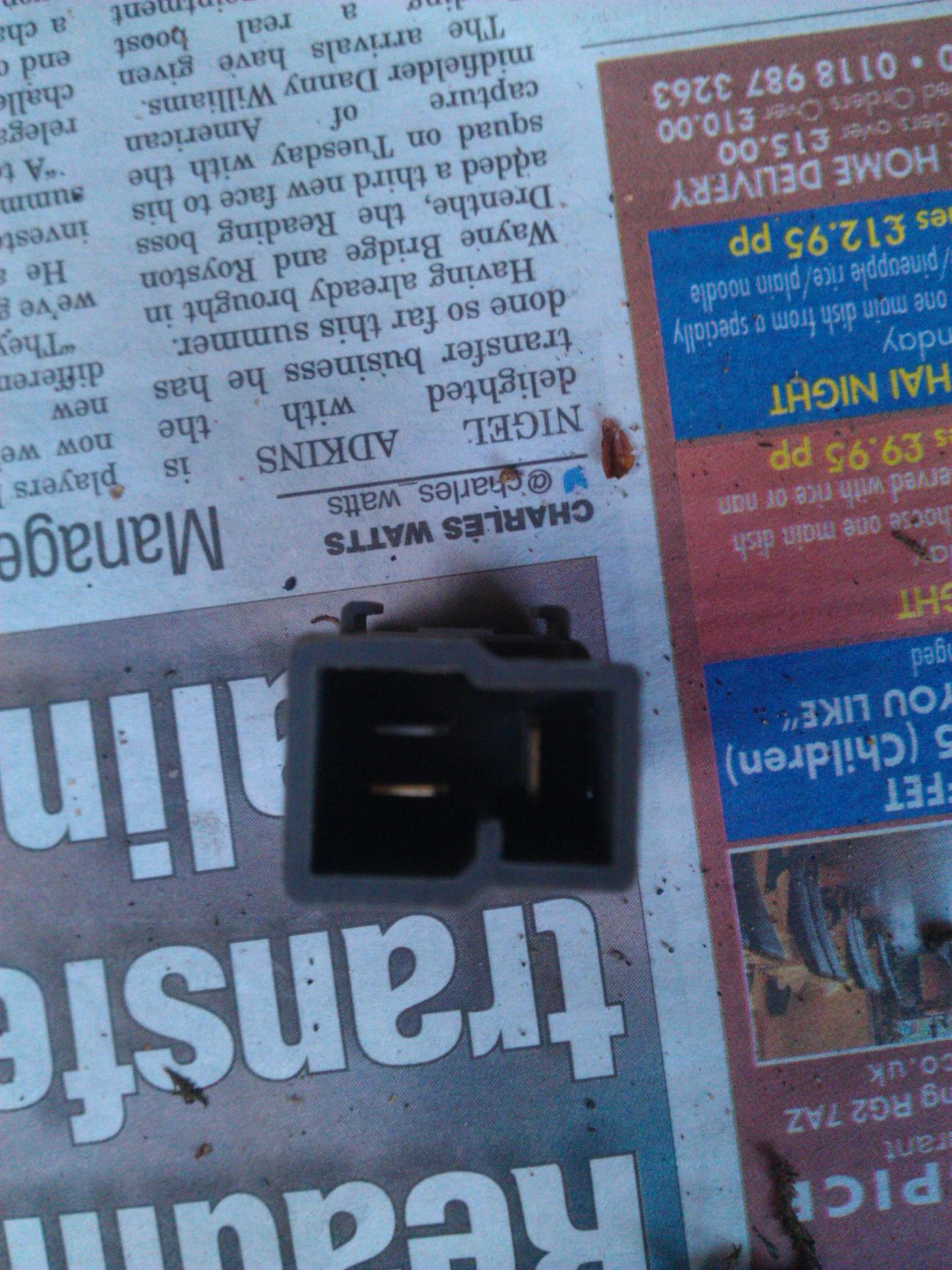

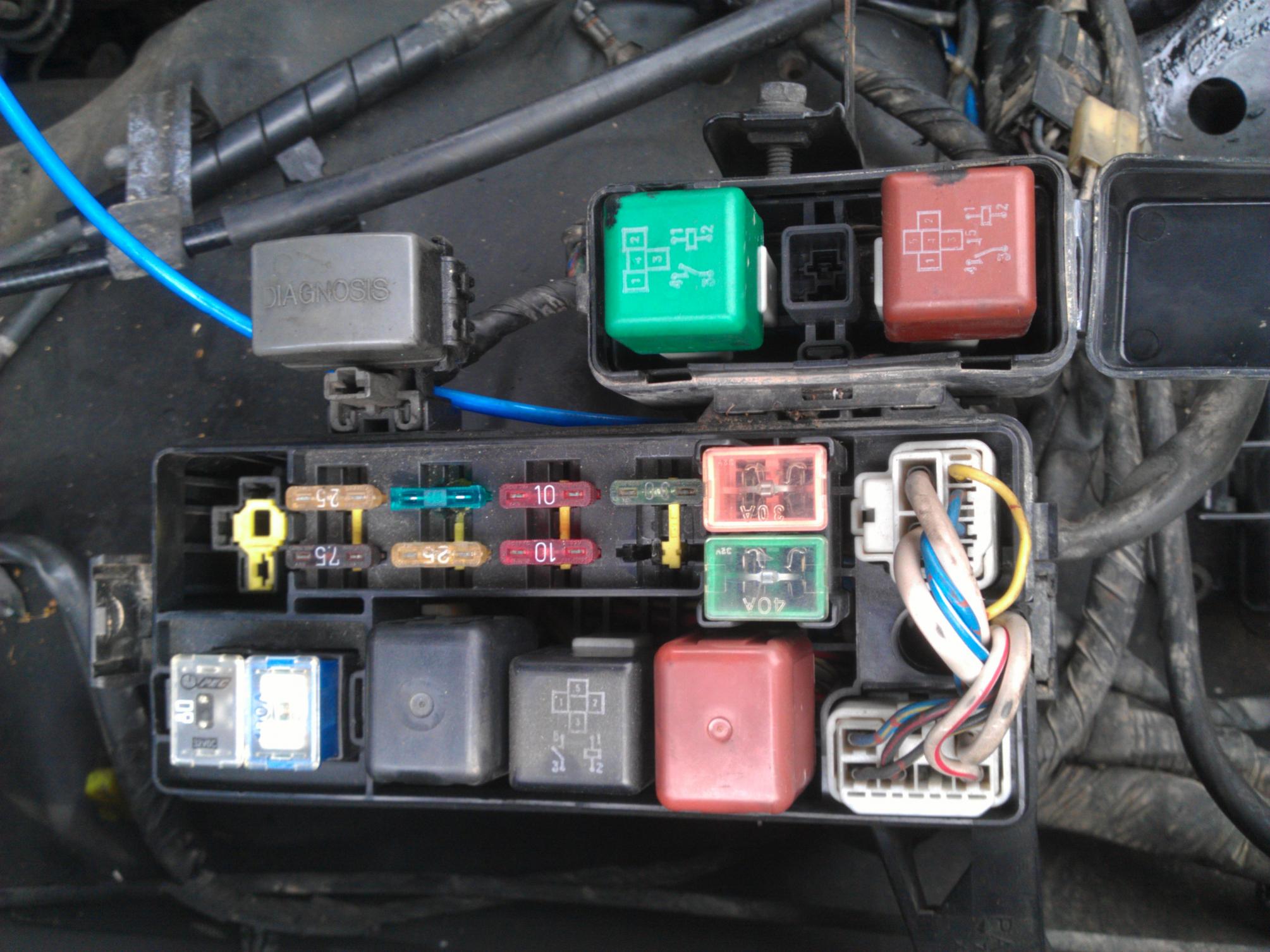

Yeah! Relay number 5, on the left withterminals like a face. Do you have the relay?
So it looks like it comes away at a different point from what I was expecting, if that makes sense.
Very helpful much appreciated. If you have the relay and are able to say how it comes out I.e. if there's a tab to push/pull which I can't see, or if it just needs yanking out, that would be great.Last edited by Tonka; 1 July 2013, 20:29.

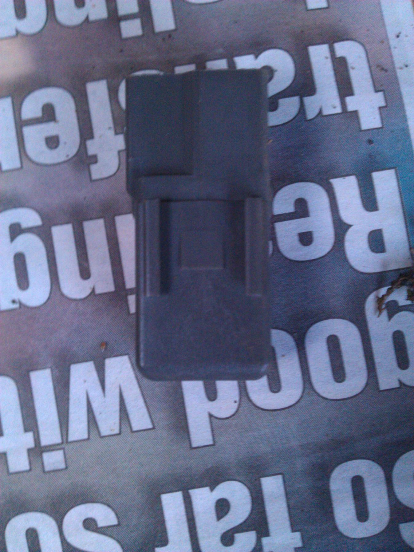

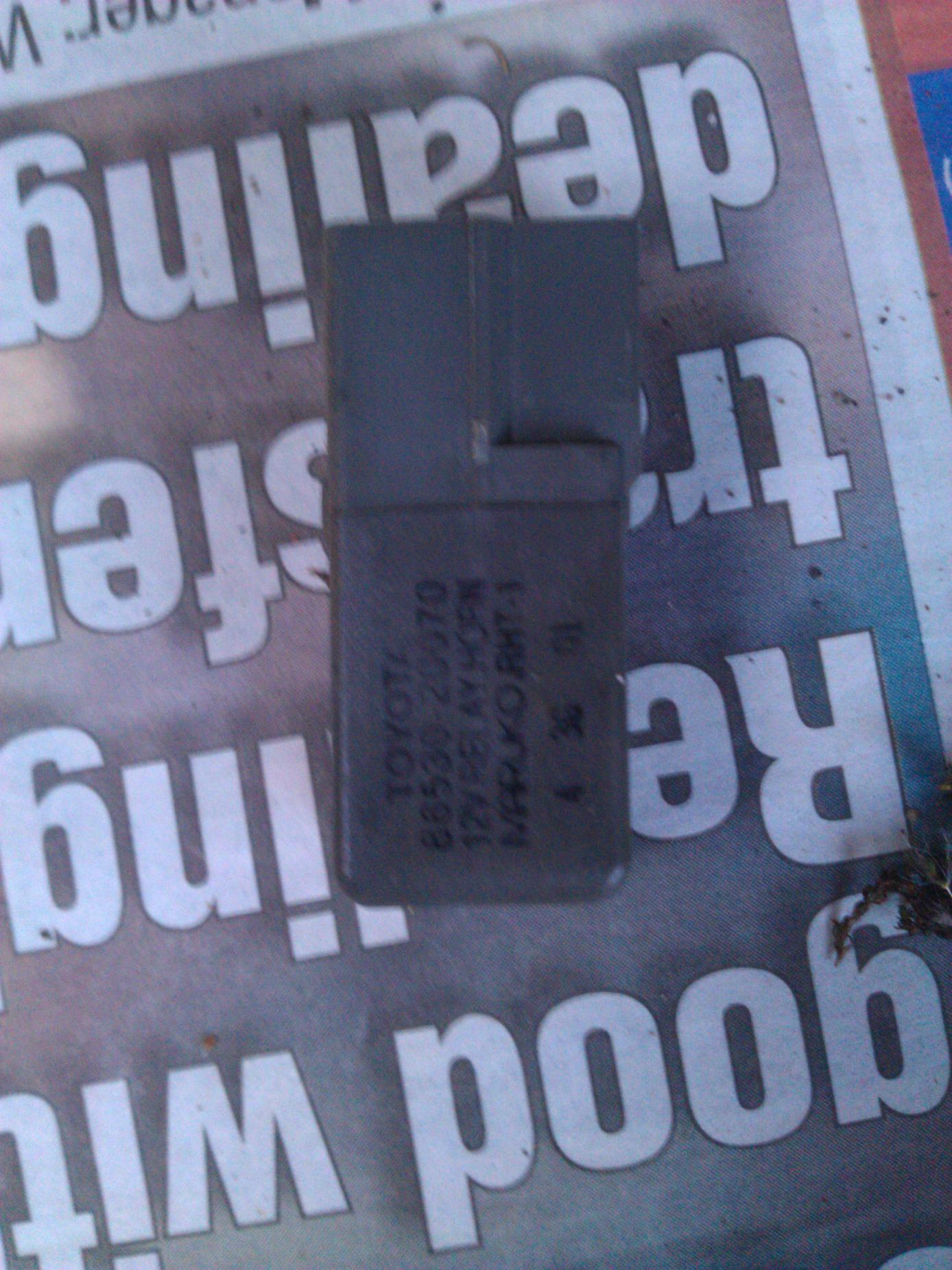

I have them in a box in the garage, I can look, gimmi 5 minutes to find it.Originally posted by Tonka View PostYeah! Relay number 5, on the left withterminals like a face. Do you have the relay?
Right, sorted the relay. The top part comes off and you can clean up the contacts and bend the arm a little so that it makes good contact when moved by the electromagnet. So, sorted and I don't have to take the grille off now to access the horns, many thanks anyway for all your help Andy, you've saved me loads of time. Are you selling bits then, breaking a surf? I might be interested in a horn relay as a spare as this one'll pack up sometime...
