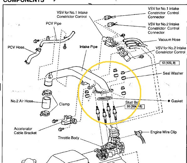

As title says, tried to change glow plugs today. The 4 nuts/bolts that hold the turbo pipe with throttle links have a knurled top with the nuts below. 2 nuts undid but two unscrewed with the screw body attached. I was not sure which was correct. Can anyone give me a clue? The 2 which unscrewed with the body did not want to come out, but kept on turning, should something be holding the splined/knurled top whilst using a spanner on the nuts? Thank you.
