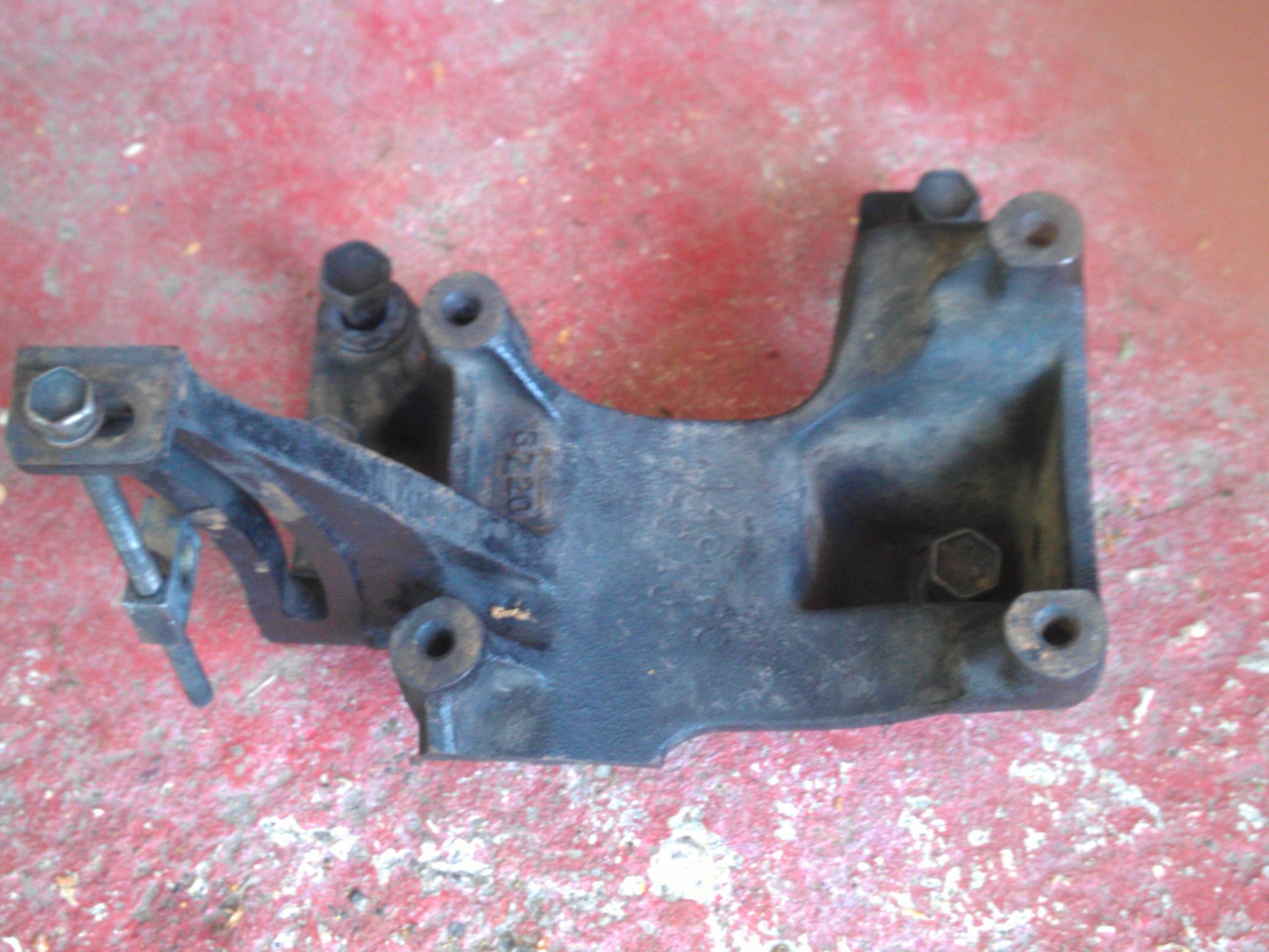

          how do you adjust the tension of the belt and how tight should it be?
            There is a download available out on the net (bit like a Haynes Manual but not) and that gives the belt tension figures. I have it somewhere so when I get a chance I will post the figures.
            When my mate tightened my belts, he seemed to be adjusting something on the left side of the alternator. He should be round in the next couple of days so I'll get him to show me and I'll get a picture posted of the bit to fiddle with (unless someone gets there first.

              on the 2.4 the adjuster is at the bottom of this pic under the AC compressor. hope thats of some use.
              A
              apologies for not rotating that, windows 8 is doing my head in!
              oh and there's a bolt through the bracket on the rod to loosen, not in the pic obviously.
