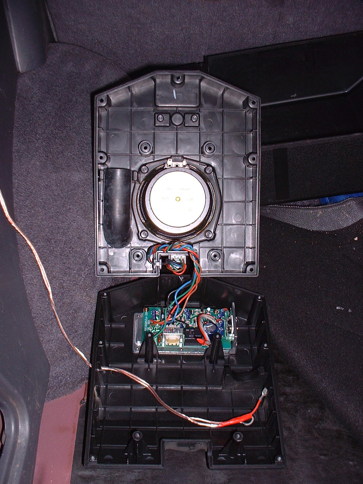

They are in mine mate. One in each speaker pod.

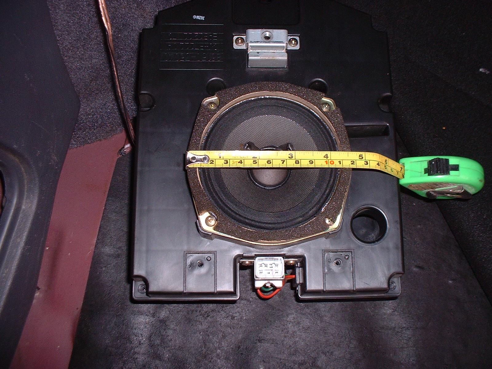

This is them:Originally posted by dabigmanthat's just the japs being wierd again!...
i always thought that's why the speakers were 2 ohm... because they were components running through crossovers. could be active crossovers?
of course mine is completely different so i can't say cos i've nener seen the 2nd gen ones... so i'll just keep quiet! hehehe!!Rubblebags (Geoff).
