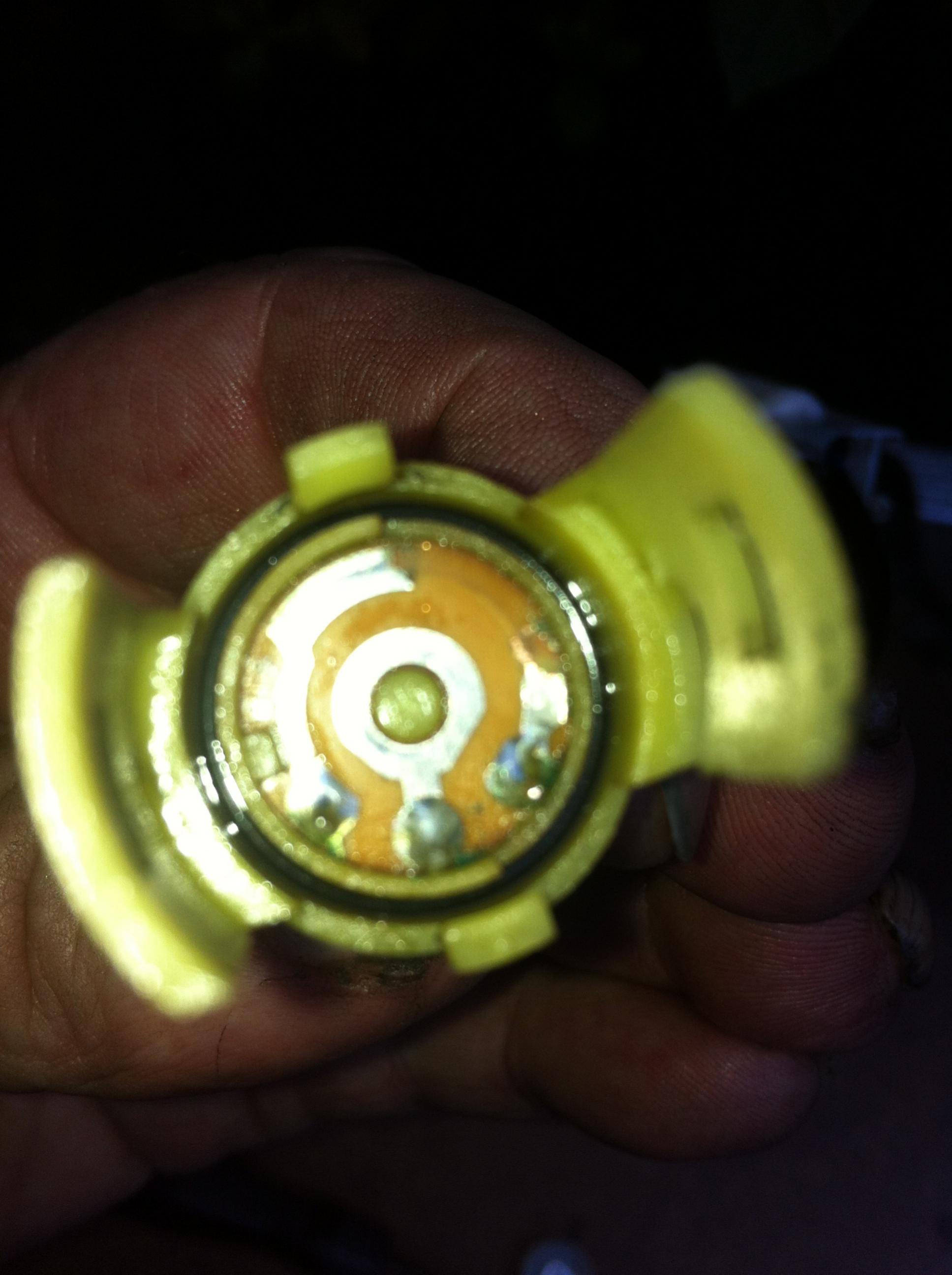

    I posted on here the other day as my tailgate window goes down randomly. This is not a cure for this but it may help others where their key doesn't operate the tailgate window. On my hilux the key would put the window up but not down. It turns out to be the printed circuit board in the plastic block that is connected to the end of the lock barrel. You will see the circuit strip on the right is worn away. This is the side that makes the connection for the window to open. I will be making a new printed circuit board for it in the next few days and will post picks of it and let you know how it goes.

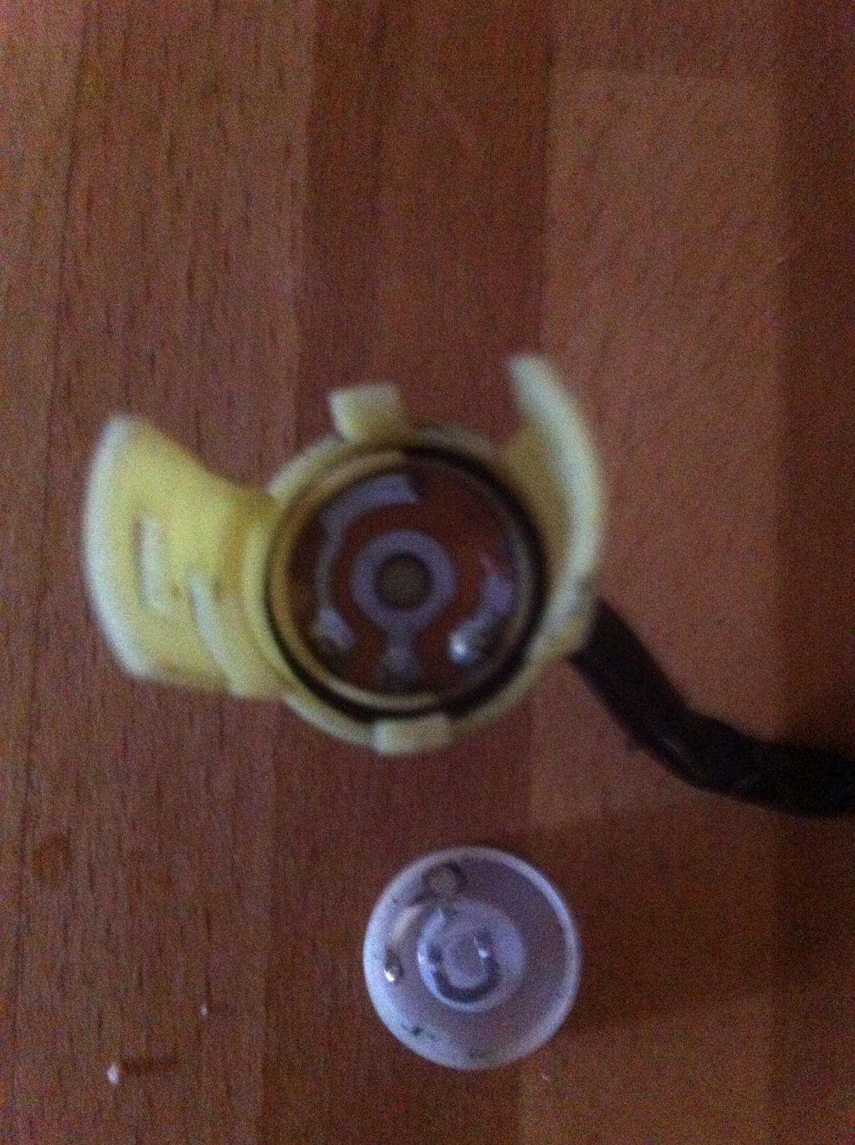

        I unbolted the lock barrel from the inside. Then uncliped the connector block. Then removed the lock barrel from the wiring harness and uncliped the little circular disc to reveal the circuit board. I then unsoldered the 3 wires from the circuit board. I will post photos when I get time. I have now made 3 of the circuit boards but have yet to fit and test one. Once I have done so you are welcome to one (free!).

            Sorry for the delay. I finally have made and fitted the little printed circuit board and it works!! The rear window operates as it should. I did make a couple of spares if anyone needs them.
