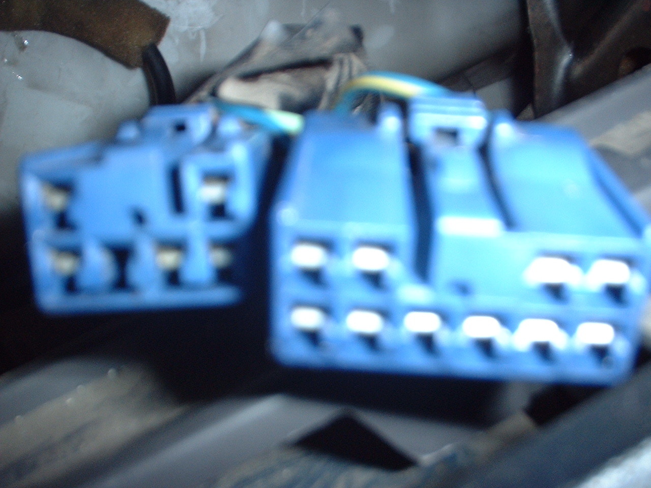

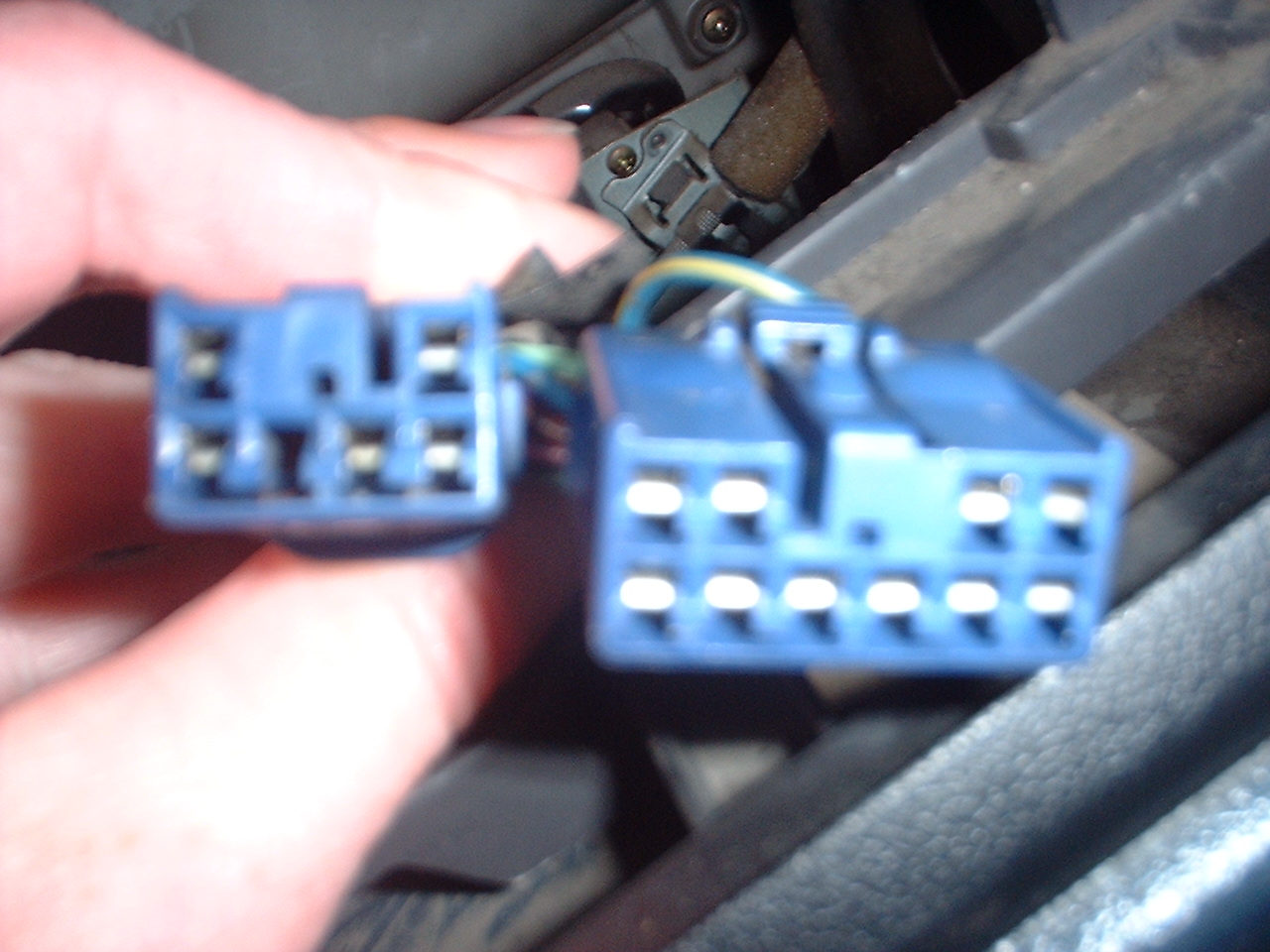

after trying 4 at least an hour to get the old radio out 2 fit a new 1, realised i need adapters from the surf 2 the new radio, can i buy these from halfords, just didn't want 2 waste the whole of my dinner hour searching in the wrong shop...and going hungry.
adapters 4 radio
Originally posted by shellyafter trying 4 at least an hour to get the old radio out 2 fit a new 1, realised i need adapters from the surf 2 the new radio, can i buy these from halfords, just didn't want 2 waste the whole of my dinner hour searching in the wrong shop...and going hungry.
Should be able to get them...Think you need the ISO connector...other smay be able to confirm this.Gaz

For anyone fitting a UK radio, the lead to convert the Toyota plugs to the ISO std is available at Halfrauds Part No PC2-17-4
This plugs straight in and works without modification (in most cases)
It was £11.99 but you may get one cheaper elsewhere.Ian
