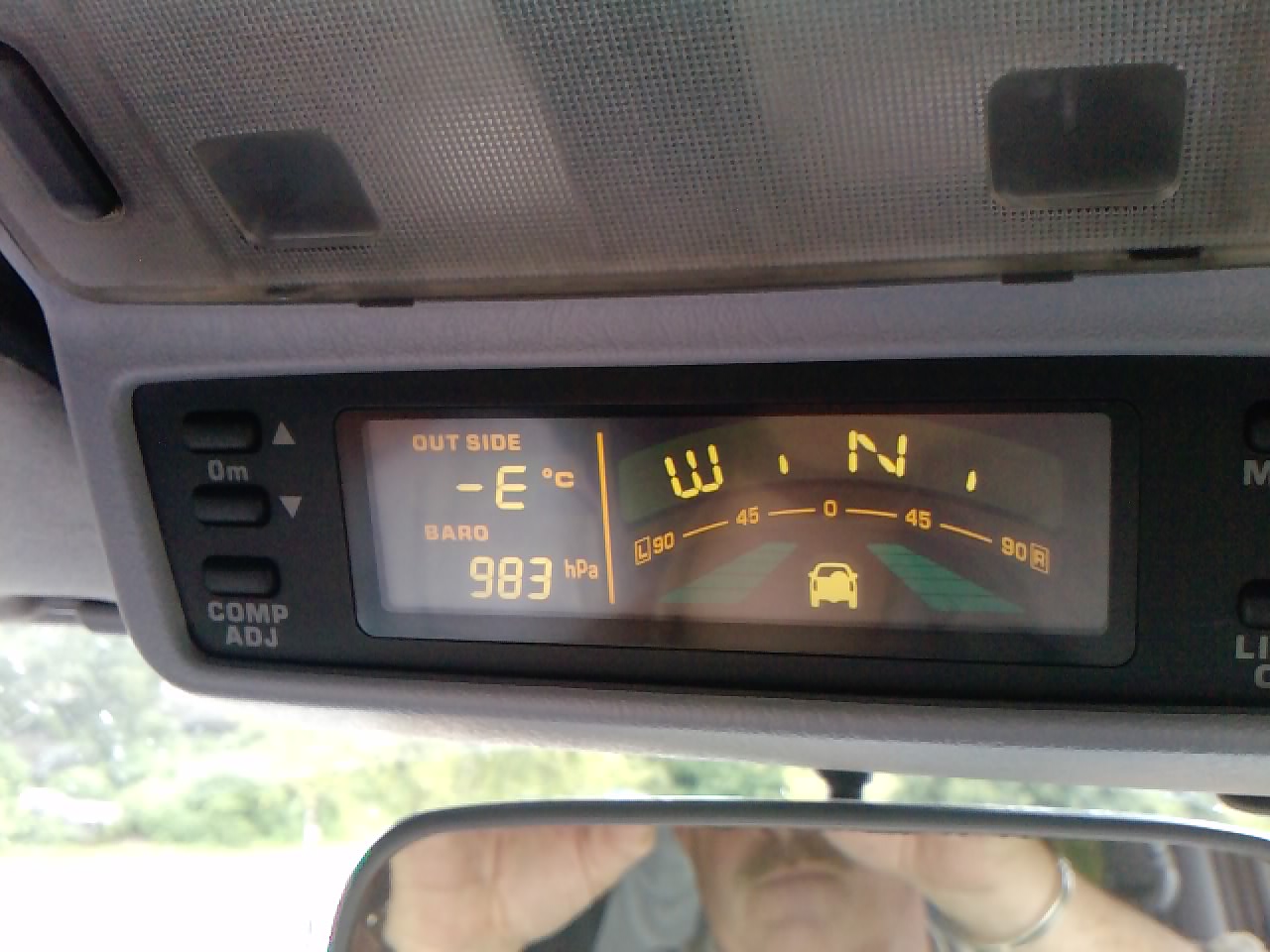

    Anybody have a wiring diagram for this console, or any other information. I'd like to know where the sensors are as my temperature reading shows 'E' all the time, presumably meaning error. The altimeter and barometer don't seem to stay set correctly either.
    Any help much appreciated.

        The outside temp sensor is mounted behind the front bumper and maybe broken or disconnected which will give the E symbol .

            The altimeter comes on when you press the mode switch which is just out of view on the right. I tried the compass adjust button which makes the symbols flash, but I don,t know how to make the direction move to correct the setting. I tried the up/down adj buttons but it didn't seem to have any effect. The compass does move as the vehicle moves but isn't anywhere near accurate.
                Thanks, I'll have a look for that tomorrow and check it out before I try the 'hard reset' suggested.

                    The altimeter WONT stay accurate. Its a barometric one so will change as atmospheric pressure changes.
                    best way to use (!) them is to zero it at the bottom of whatevr climb you're doing so you know your overall change rather than use it as an absolute measurement of altitude.
                      I'd be more inclined to ignore the lot unless your stuck in the Sahara and only keep an eye on the temp guage, then again, that doesn't work properly anyway.
