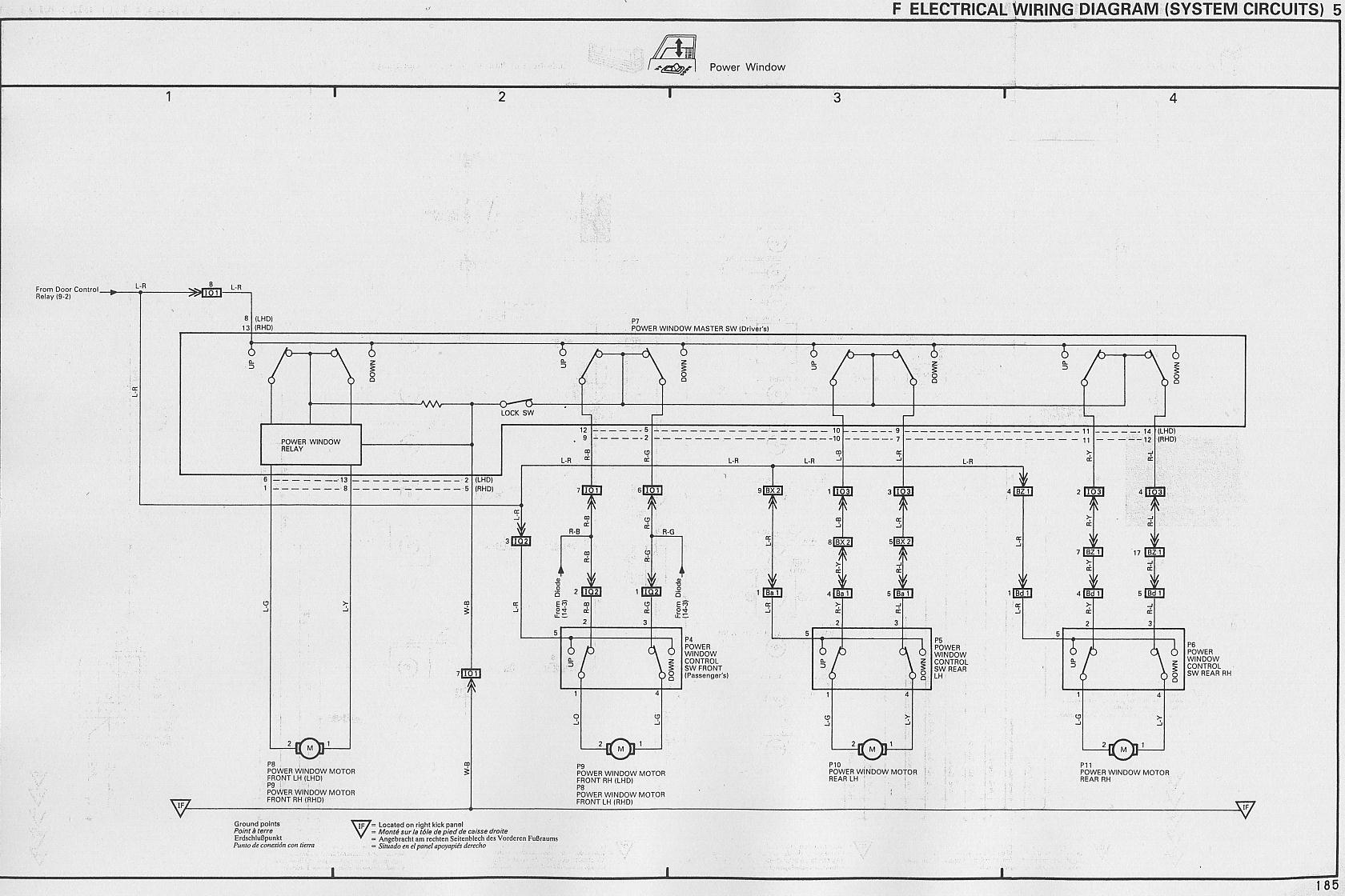

    anyone have any wiring diagrams please?

      surf wiring digram
      Hi here is a wiring digram for the surf electric windows
      Dom
