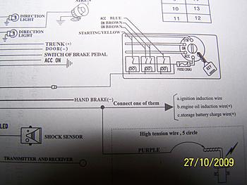

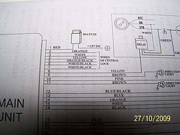

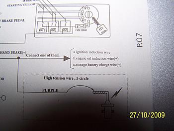

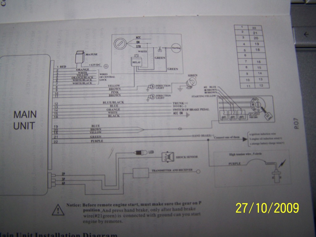

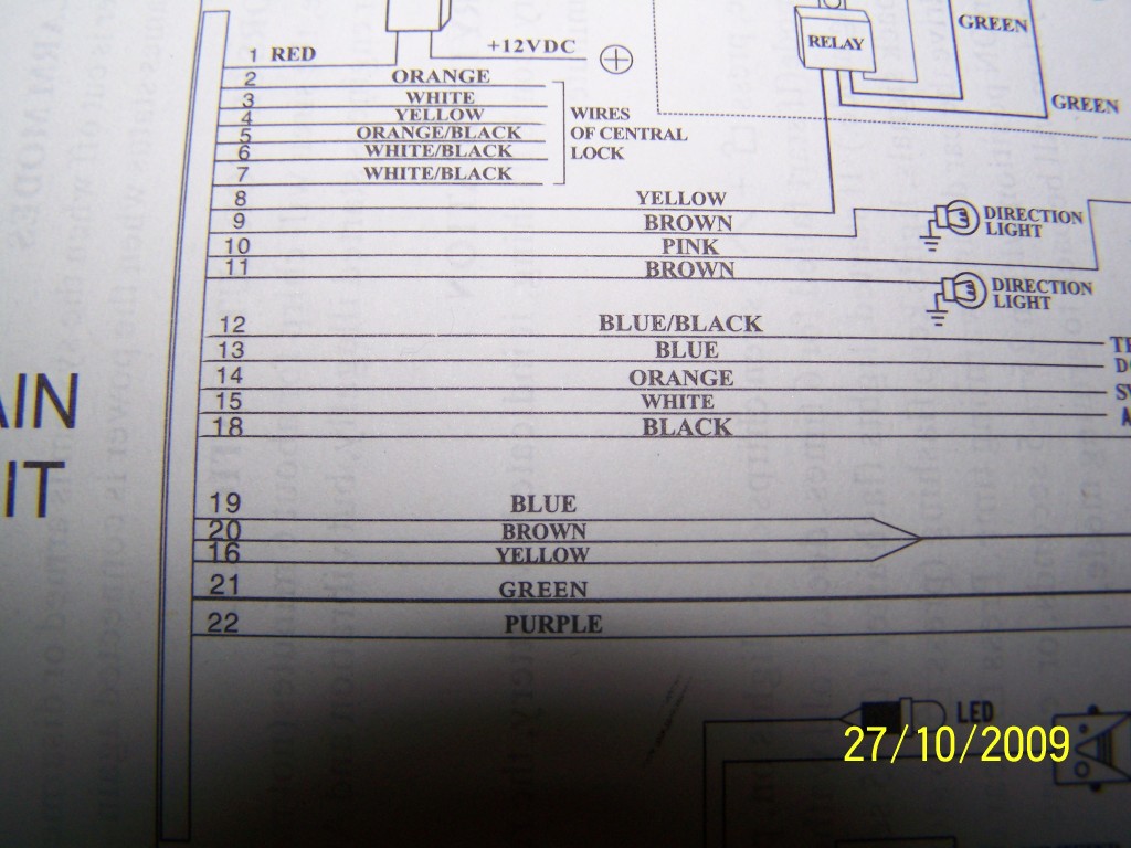

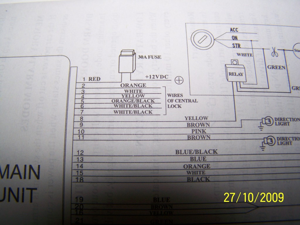

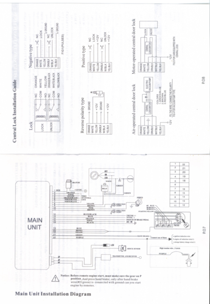

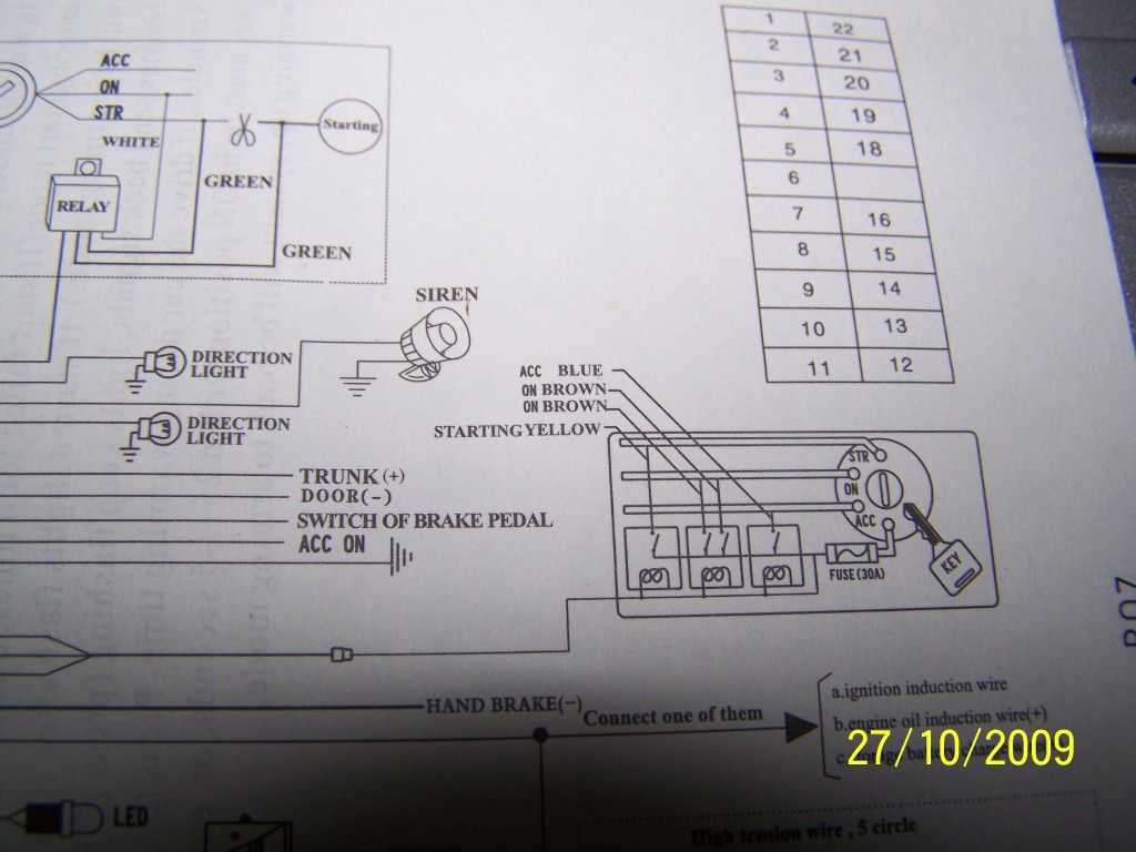

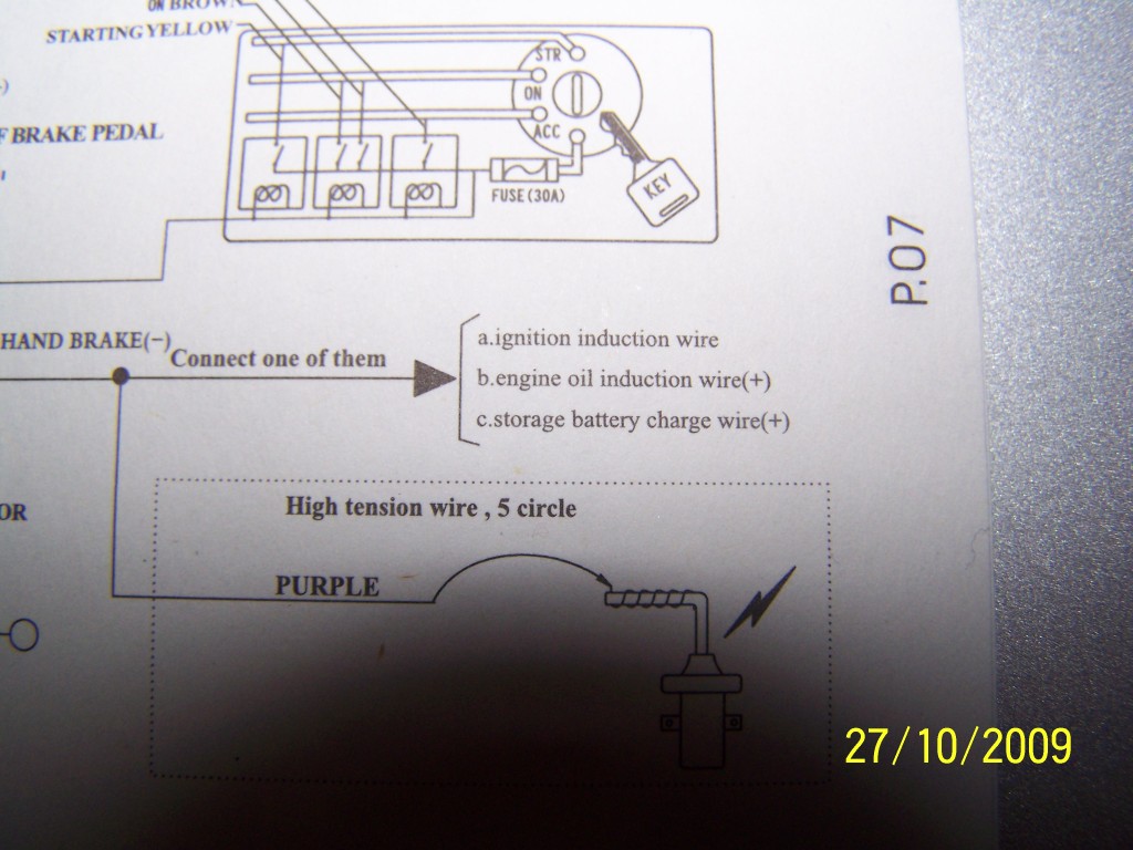

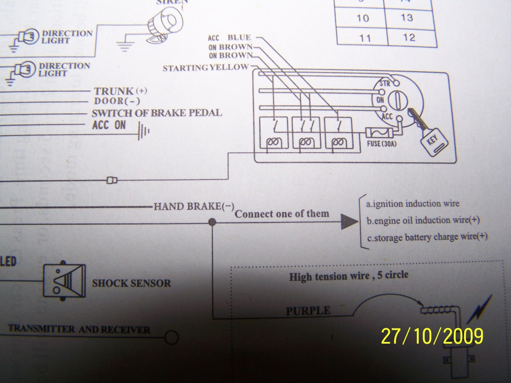

I have been given an alarm which I am planning to fit and am trying to get an idea of where all the wires go before I start taking things to bits on the surf, I've think I've located most of them but am having trouble with Purple wire at the bottom (wiring diagram below) if anyone can shed some light on what exactly I need to connect this to it would be much appreciated since I can't find a reference to any of the three options in the surf/4runner manual.
