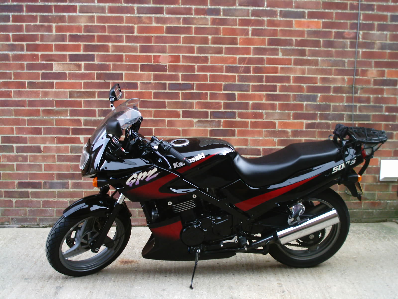

        Thanks Guys, looks like the alternator wins. And its not the sort of thing you can pick up in Hallfords on a Sunday morning (lol). Just when I need the car to move my 82 year old Mother in Law out of hospital into a care home tomorrow!!! Hope she likes riding pillion as other form of transport is a Kawasaki motorbike- still.at least its a Jap.

            nice bike, had myself a GPZ1100 many moons ago, only bought the surf after my Honda XR400 was nicked last april
            hope the mother in law is ok
