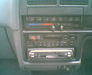

    My SSR-X 3.0L. Came with a radio/tape deck and a faulty cd player.
    I removed the cd player and put a Sony CDXF-5500 cd in it's place. Used a car audio connector from Halfords part no. PC2-17-4. I kept the radio/tape in place cos' i didn't want a box fitted. there was no alteration to the fascia/dash board. The wiring l didn't have to cut. So all in all a great job done. See the pic. and make your own judgement. Thanks to previous info on this forum which helped.
