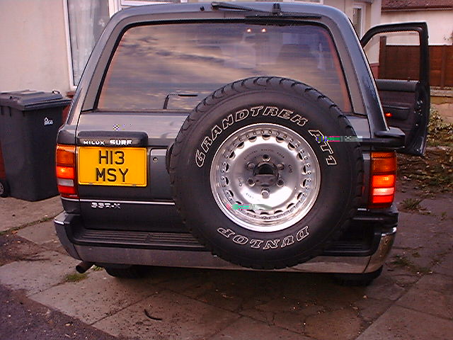

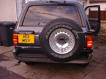

I've turned my drivers side reverse lamp into a foglamp - pic available if required....
All seems okay - just waiting for some fog now !

A picture with lamp off.... and one with it switched on.
Bear in mind the camera does it no justice and enhances the whiteness of the lense. The Light emitted is very red !
As for doing it, it's quite simply a case of chopping the original reverse lamp wires and replacing them at the back of the lamp cluster with the foglamp feeds.
If u need anything else, just let me know.
