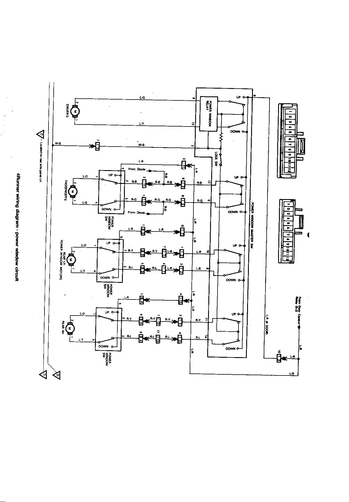

                  ok, i have found the wiring diagram
                  You would need to fit a latching relay (power window one) inline with the existing switch block and the motor. then in effect you would have a remote start switch just like the drivers window that would work from both the inside and external switch. coool

                      i guess all you did was connect your live supply from the drivers supply switch. that is bypassed from the lock switch so you can lock all windws except the drivers - maybe in your case the rear one too.
                        sparky, you seem to be the man to ask, do i fit the relay b4 or after the switch and is this going to or from the rear door, i no i'm being dumb, can handle the wiring etc did my electronics NVQ 12 years ago and havn't used it since so need a shove in the right direction, i will then have a play. am wiling to photo and doc the conversion and post once its completed, may just need a little gentle pushing along the way thats all

                            If you look at the wiring plan I uploaded you will see from the fuse that the supply goes to the drivers lock switch in the door control first.
                            When that switch is close (in the on possition) it then goes through the switch and out to four contacts one on each window switch.
                            Each switch has two cables (open winding and Close winding) these both run from the switch to the window relay in each door I assume (though don't quote me on that location)
                            WHat you want to do is install your new power relay in replace of the relay that switches the back window.
                            Ie, the open and close wires from the door switch would then run to your new power relay. then out of the relay you would connect the open and close wires to the motor.
                            I could do with having a look at a power relay to see what connections it has on it. Then I could be more descriptive.
                            I'm away to Australia next week until april - though its a while away, when I return I will have a play with my one and if I get it going I will put a detailed guide on here as I think it will be a good mod that alot of others would do.
