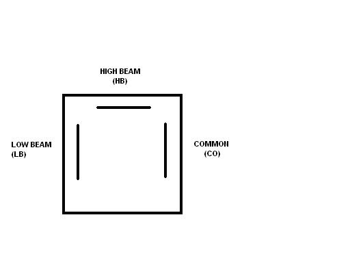

OK, i'm not sure if this'll help but as you look at the plug you have
(HB)
HIGH BEAM
(LB) | | (Co)
LOW BEAM | | COMMON
edit: It messed me diagram, check the pic attached
HB & LB might be the other way round, i can't remember.
Lights off all 3 have earth.
Lights on dipped: Co + , LB - , HB +
Lights on main: Co + , LB + , HB -
So they are actually switching the earths to switch between dipped and main.Last edited by nero279; 31 October 2007, 20:04.=========
