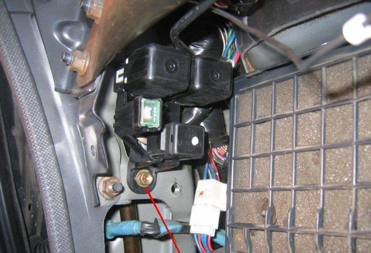

          When recently stripping the dash out I found a myriad of relays, boxes and fuses.
          These relays in the pic are located behind the glove box tucked up by the air intake.
          Perhaps one of these controls the fan motor?
