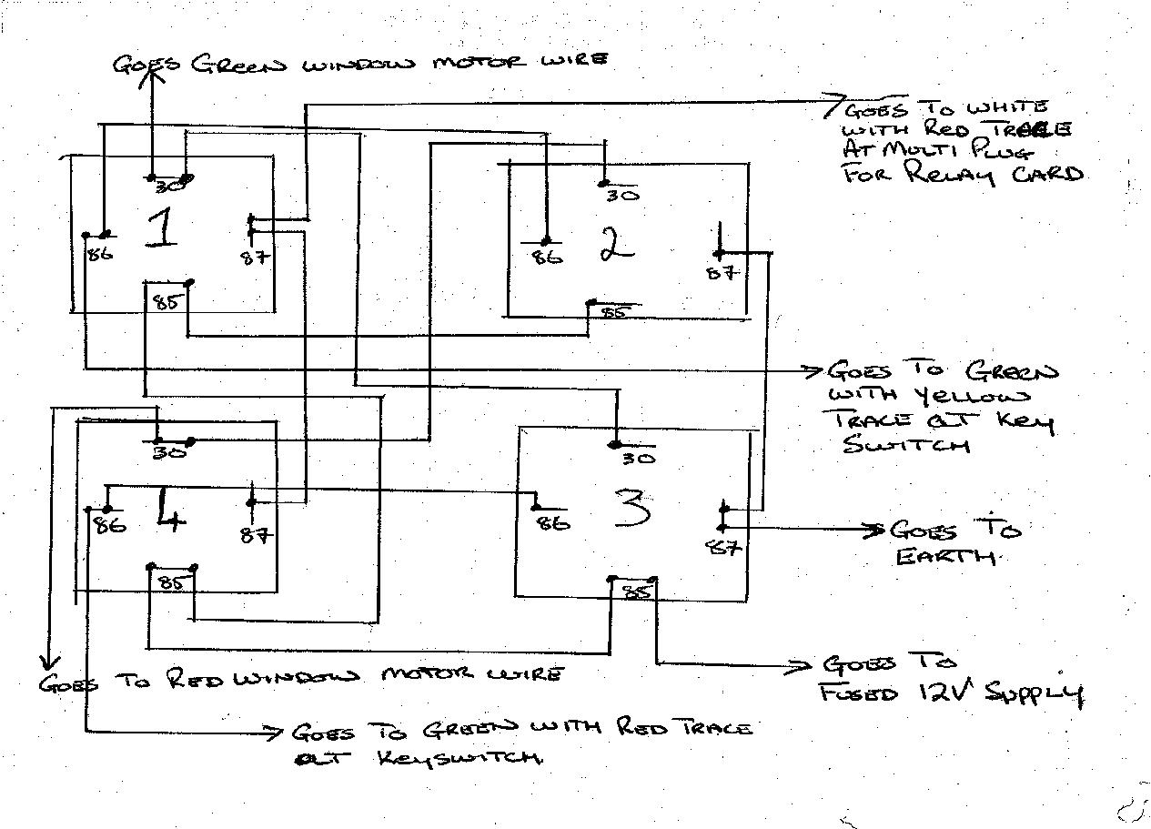

I have today recieved a letter from our surf buddy PAULEDS from France.
He has had a few problems with his surf and has asked me to put this on the forum.

The thing he is struggling to fix is the tailgate window, he says he can hear the relay clicking but he cant find the window relay.
