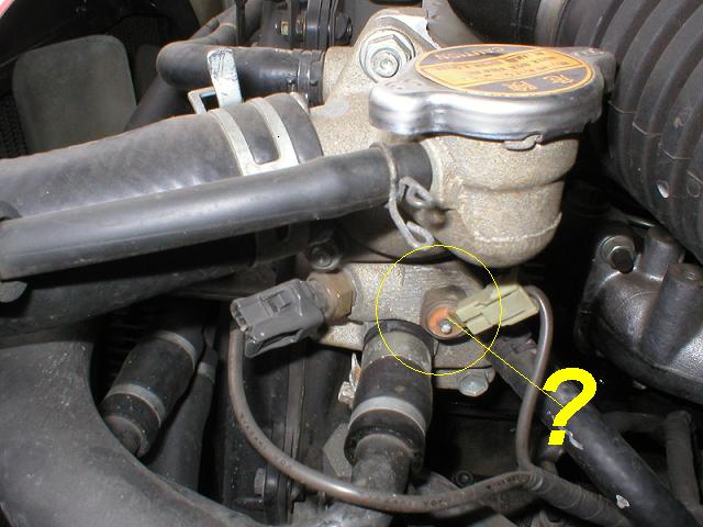

          • #20
            Originally posted by tich
            Mornin` chaps
            Seems I need your help again!.
            I`ve got a bulb gone in my interior light ( the front one by the mirror ) but cannot see any obvious way to remove the light and switch cluster. Anyone been there?.
            Also, while I`m here, PLEASE PLEASE is there a real clever bugger out there can tell me how to get to the blasted water temp sensor for the after glow which is apparently situated under the inlet manifold somewhere. I can`t even see the damn thing, let alone get to it!!! . Do I have to remove half the top end to get to it?.
            Regards
            Tich
            Hi Titch
            Hope this helps.
            Pic 1 shows the inlet manifold side of the engine.
            Pic 2 shows circled what I think you are after. The two wires go to a sensor. As far as i remember the sensor is screwed into the inlet manifold.
            I have just been out to the surf to feel for the sensor and it is sitiuated between the ports level with the cast iron ERG manifold where it connects to the inlet manifold.
            If it is this sensor its going to be a pig to get to.
            Good Luck
            Geoff.
            Rubblebags (Geoff).

              • #22
                Originally posted by rubblebags
                Hi Titch
                Hope this helps.
                Good Luck
                Geoff.
                Great Geoff, thanks for that. It certainly looks like thats the boy.
                I think your right its going to be a grunter to get to.
                Tich
                • #23
                  Tich
                  The unit that I have described to you is the glow plug resistor. (haynes manual).
                  The one on the side of the block (top right hand) is the water temperature sensor.(haynes manual).
                  Good luck
                  Geoff.
                  Rubblebags (Geoff).
