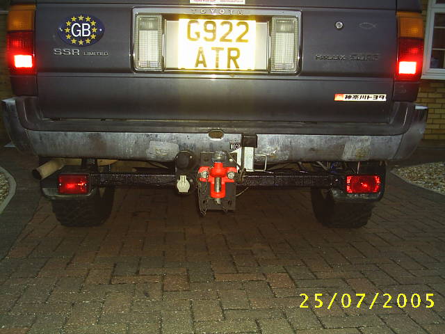

First job is to affix the additional rear fog guard, I have two because whether in UK or Europe I always have a rear fog on the off side.
Both of mine are on the rear tow bar frame, on the far left and right- workable but do get bashed sometimes when off road. I reduced impacts by using square ones, screwing with self tapers through the back the back of the lamp so they fit flat on the towbar frame.
With an existing lamp it was easy to run a 8amp wire between the bulb positives (centre), using the spade terminals- the original lamp ends up with two wires in the middle in the same terminal.. The earth sides of the bulbs were taken in to ring tags and fixed to the towbar chassis. All wiring is kept ontop of the towbar frame and held with ties.
Simple test, side lamps on, fog lamps on and you should have two rear fog lamps on

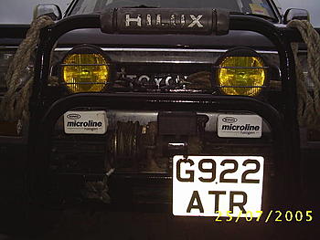

Bolt on the front 2 pairs of fog lamps (use one if you want) , mine are above bumper height, affixed to a square lamp bar behind my bush bars. Up to you- but must be legal distance from vehicle sides and other lights. Check instructions from light pack.
Connect short wires from all of the bulb negatives with spade and ring tags to the metal work that supports the lamps. I used the mounting bolts.
Join the centre two lamp positives together 25amp wire (same style as for rear), run this wire behind the grill and to the drivers side fuse box under the bonnet- don’t connect come back to this later. Do the same with the other set of lamps. Masking tape on the loose ends- write front flamps pos on them.
