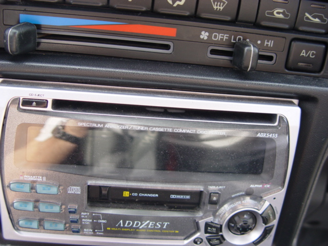

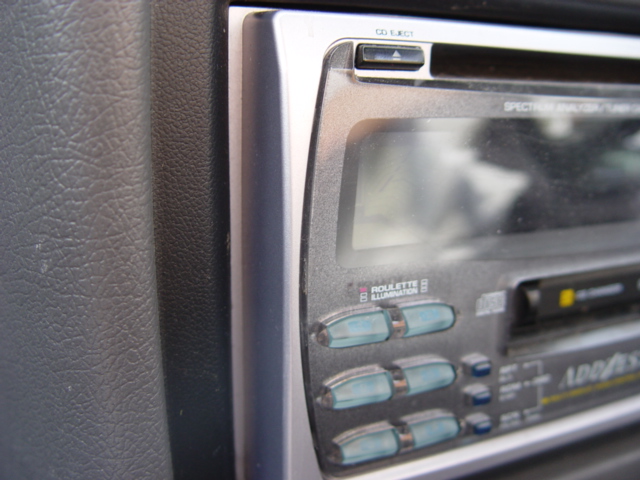

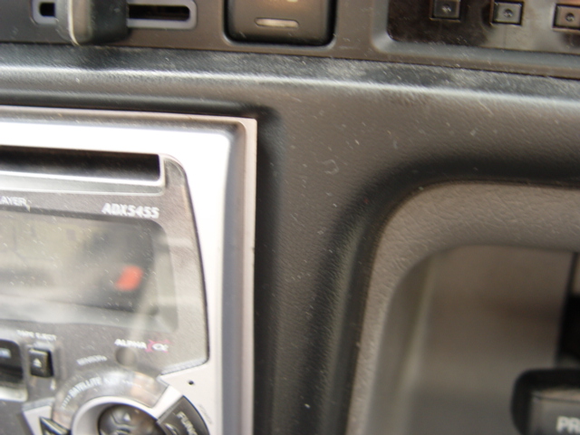

has anyone seen one of these and if so do you know how to get it out ? I cant see any obvious bits or holes to poke things into, surely it cant be a dashboard off job ? hheeeeeellllpppp !
stereo removal help
yes you have to remove the dash, its really easy, do a search on here and you will find 2 or 3 write ups, it seems all the stereos get screwed in.
I can probably take my dash apart and put it back together in 15mins now, so dont worry about it, just try not to lose any screws.

Take a look at the link below - It's a .pdf with all the info you need to remove/change the stereo, The toyota stereo is bolted in so you do have to strip the dash but it's not a hard job. Also if you fit your new stereo in the same way it is less likely to get stolen. Most car stereo thefts are by !!!!!!s who are simply looking for a tenner to get their next fix. They usually don't have the brains or the patience to dismantle a dashboard but they are smart enough to carry some stereo removal keys if you simply have a slot-in stereo.

so now i have another question, why does this guide suggest I can get away with stripping out the centre console only...
http://www.showmesome.info/hilux/workshop/dash3.htm
while this one suggests ( in great detail and with cool pics ) that i have to strip out the entire lower dash ?
http://www.installdr.com/InstallDocs...PDF/869017.pdf
I did manage to get my sterio out of my old surf only taking out the centre consul,but i wouldnt advise it my old surf was a write off ,so it didnt matter but you have a great chance of breaking some of the front dash.
If you follow the one with the cool pics you will find that
1) You will know how to take the dash of for future reference .the quite a bit you will need to get tooo behind there at some point.
2) it take less than an hour to take off put strio in or take one out and then replace.
Hope this helps
