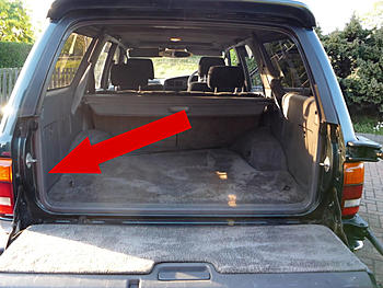

Situation:
Tailgate works as normal off front switch in cab. So, motor works, mechanism works, wiper seated, etc.
Won't work off rear key switch, up or down. Have taken apart white plastic disc mechanism behind lock barrel, cleaned all contacts, nothing. Replaced that whole cable too, nothing.
When I turn key switch, it beeps from the dash when going turning it left, and beeps a higher pitch when turning it right. Two distinct pitches of beep, however nothing happening with window.
To complicate matters further, sometimes after I've got the window down off the front switch, when trying to turn it left from the rear key switch to go up, it rises a few mm, barely above the weather strip, and stops, then does nothing either way.
I've also checked all wires out from the tailgate looping around underneath and all appear healthy externally at least, and unchafed / unbroken. In feeling along every individual wire none seem crunchy or broken inside either.
Finally, I now hear a rapid clicking sound from under the dash too (never heard it before), like a relay rapidly going off / on. AND, my rear wiper now doesn't work.
WTF is going on?! Anyone ?? HELP!
