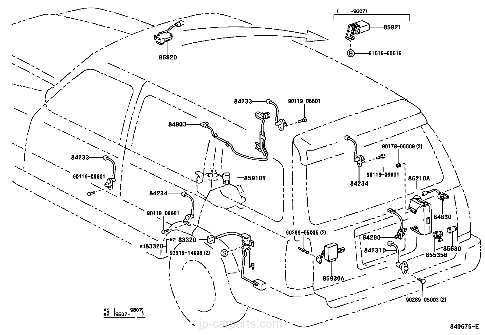

    I need a set of door switches for my Surf does anyone know what other Toyota's use the same ones?
    I ordered part 84231-32040 from Amayama, after checking the part number on https://jp-carparts.com/toyota/partl...pe=10&fig=8401 (Under the Image 9 tab).
