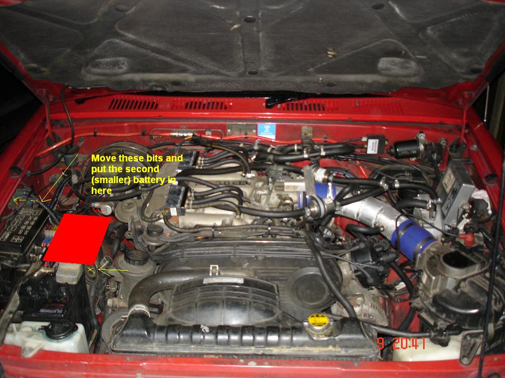

    Right then, I need to add a second battery to my system cos unlike the diesels the v6 only has the one.
    According to my local toyota dealer the alternator puts out 60amps
    already have a 70amp/CCA 570 amps
    but want to add a 45 amp/CCA 420 amps
    is this feasible???
    The only reason I am using a smaller battery is that it is the bigest one I can shoehorn under the bonnet
    Input please
    It's necessity now as I'm running more lights than a Blackpool Tram!!

    I don't think that would be a problem as the twin battery surfs alternator only puts 60amps out.
    I'm a custard donut monster
      put in a split charging relay and it should be ok?...
        From what Jon has put I guess it will be ok
        NO WORRIES!
        Rusty
          You shouldnt have any problems there with a split charge relay, although the alternator only puts out 60A thats more than ample to keep 2 good batteries charged. I have two batteries on the 4runner one through a split charge relay no problems at all, and when i put the caravan on the back i have THREE batteries because the one in the van gets charged and runs the fridge! It takes a lot to draw 60A from an alternator you would basically need to remove the battery and switch on everything you have!
