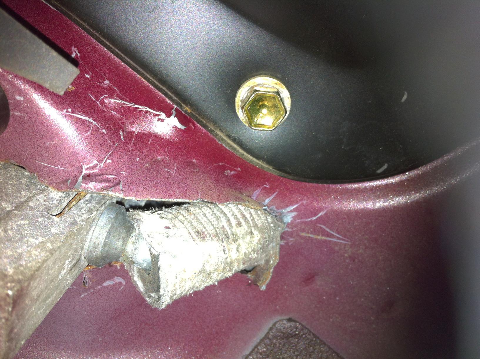

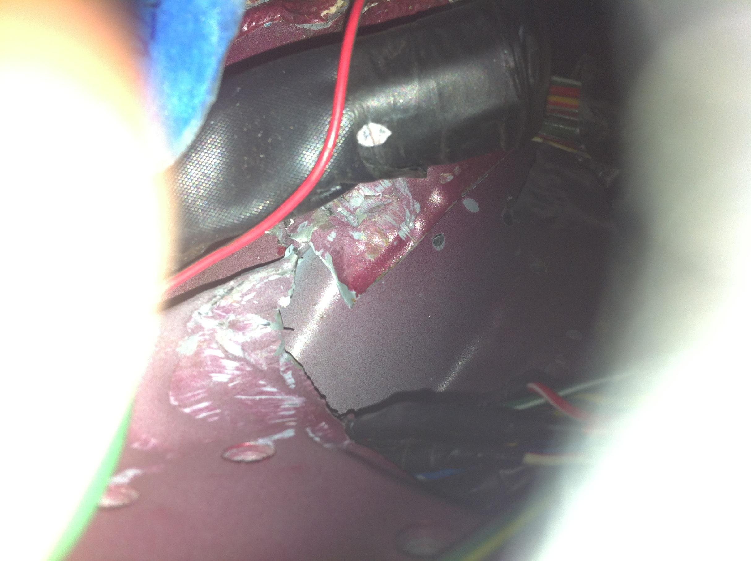

                              Nice cutting away of metal for the re-location of the handbrake mechanism. See 1st pic below.

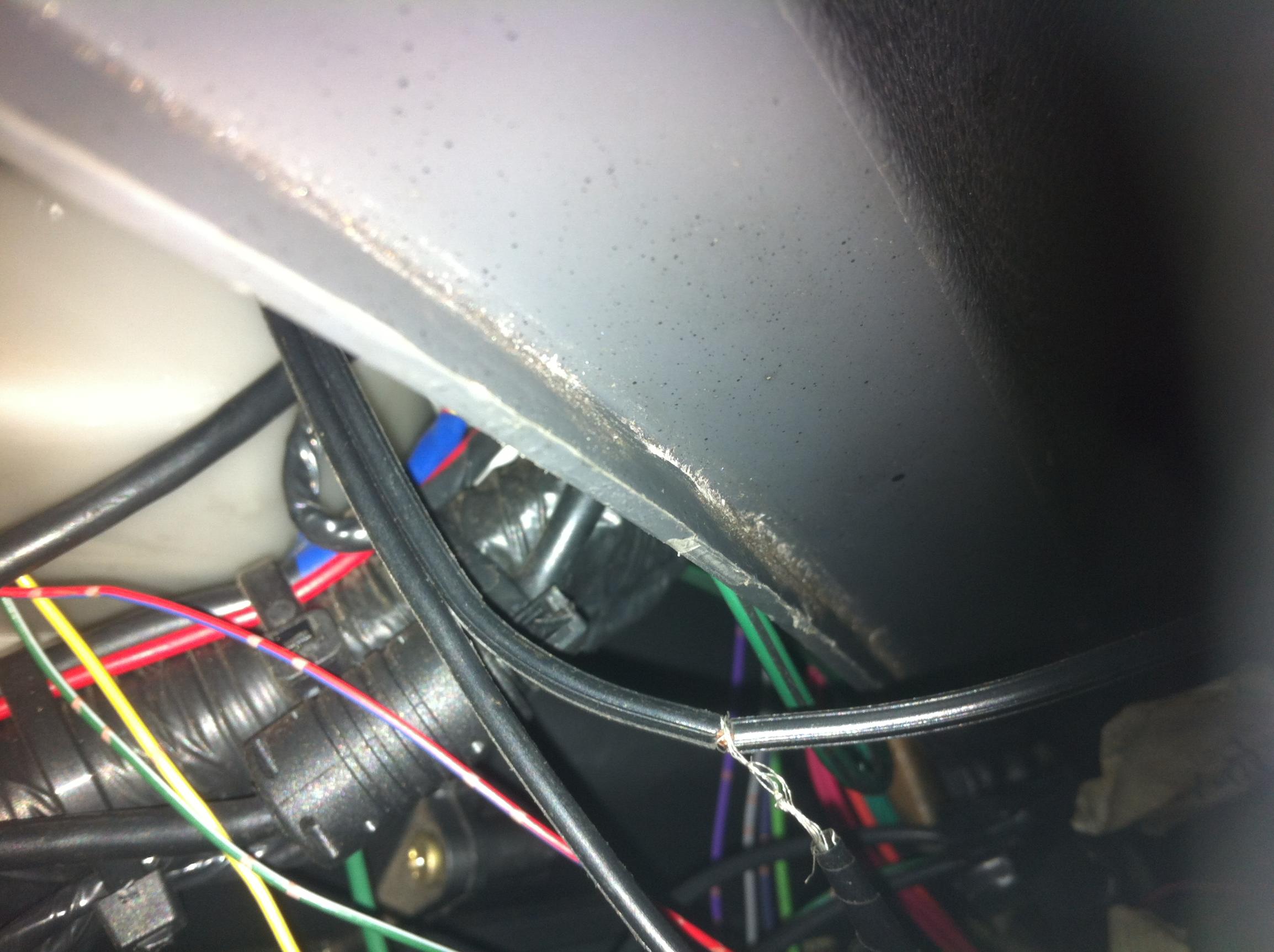

                              A sharp edge left behind the ecu - original loom runs right across this! see 2nd pic.

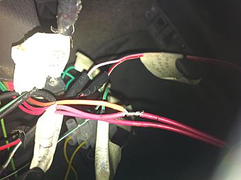

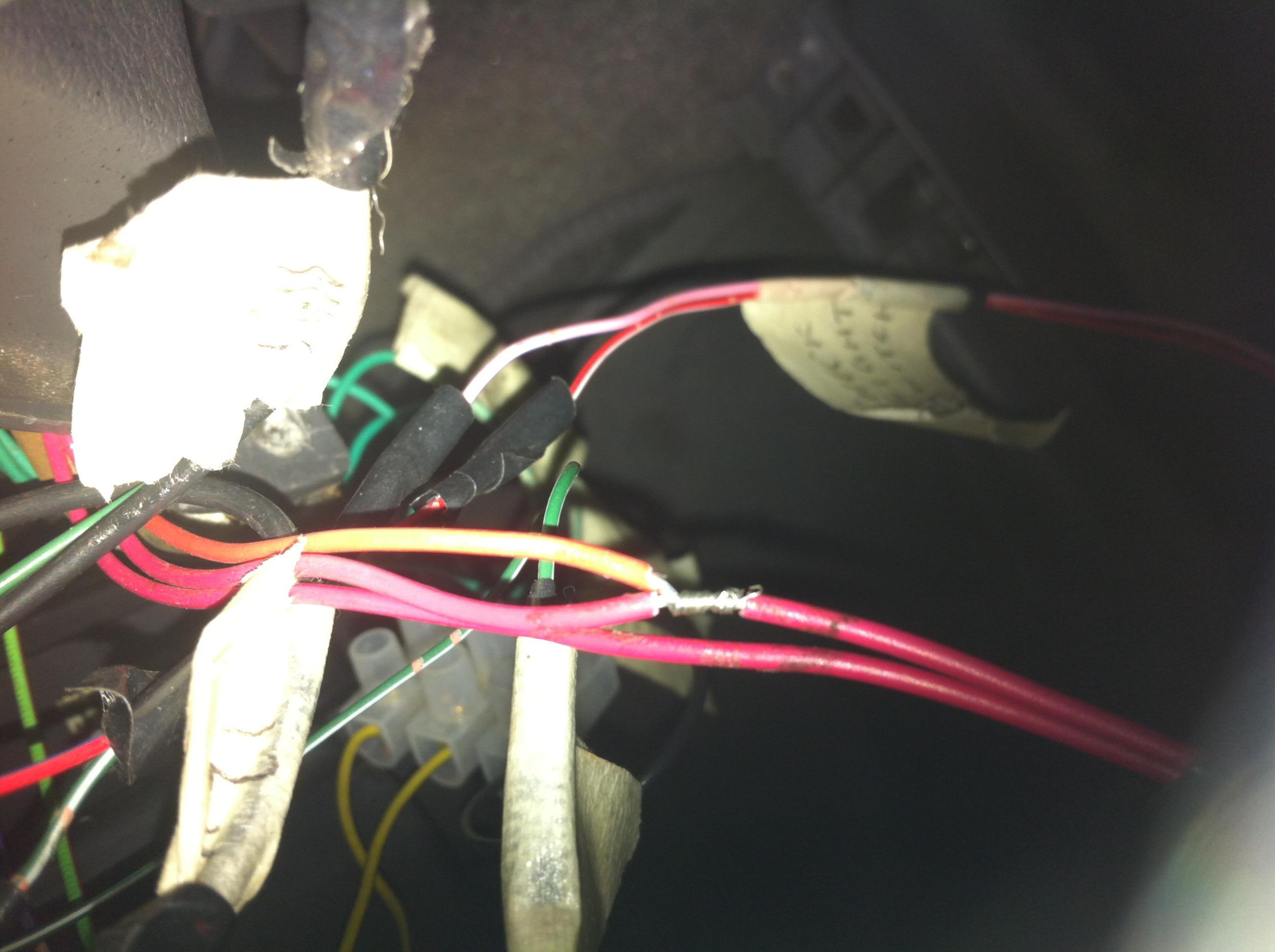

                              Had intermittent problem with the auxillary gauges - looked at the wiring and found this, not soldered - just twisted together - pic 3 & 4.

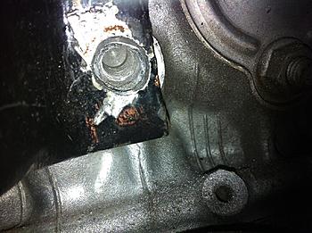

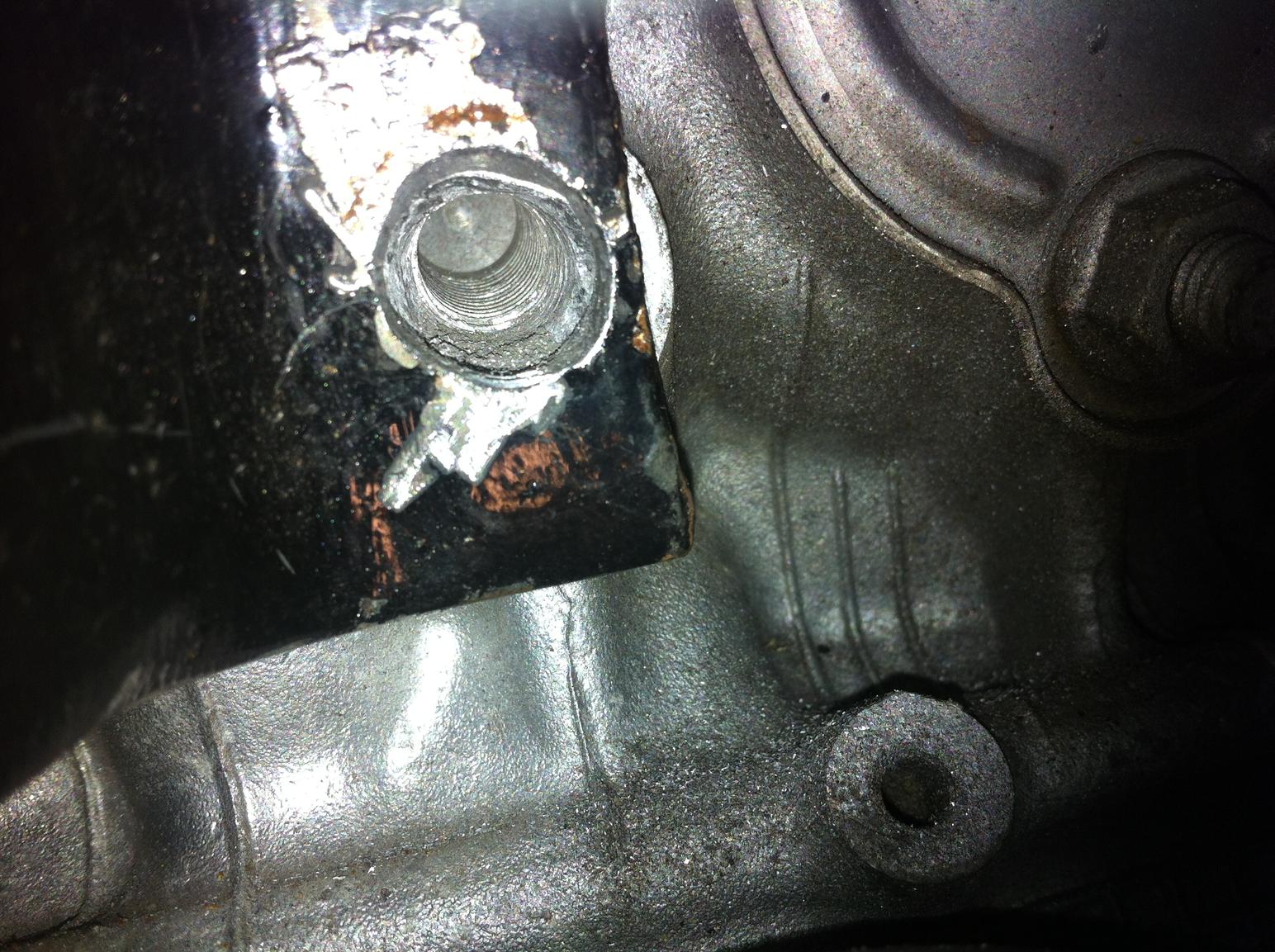

                              Got round to looking at the issue with why I couldn't get a fourth bolt to screw into the engine mount - holes don't line up. Spent 6 hours on this, drilling and re-tapping the start of the threaded hole in the block as it was gnarled up. Pic 5.
