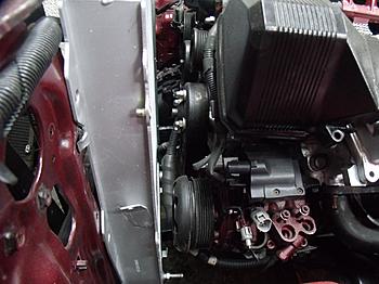

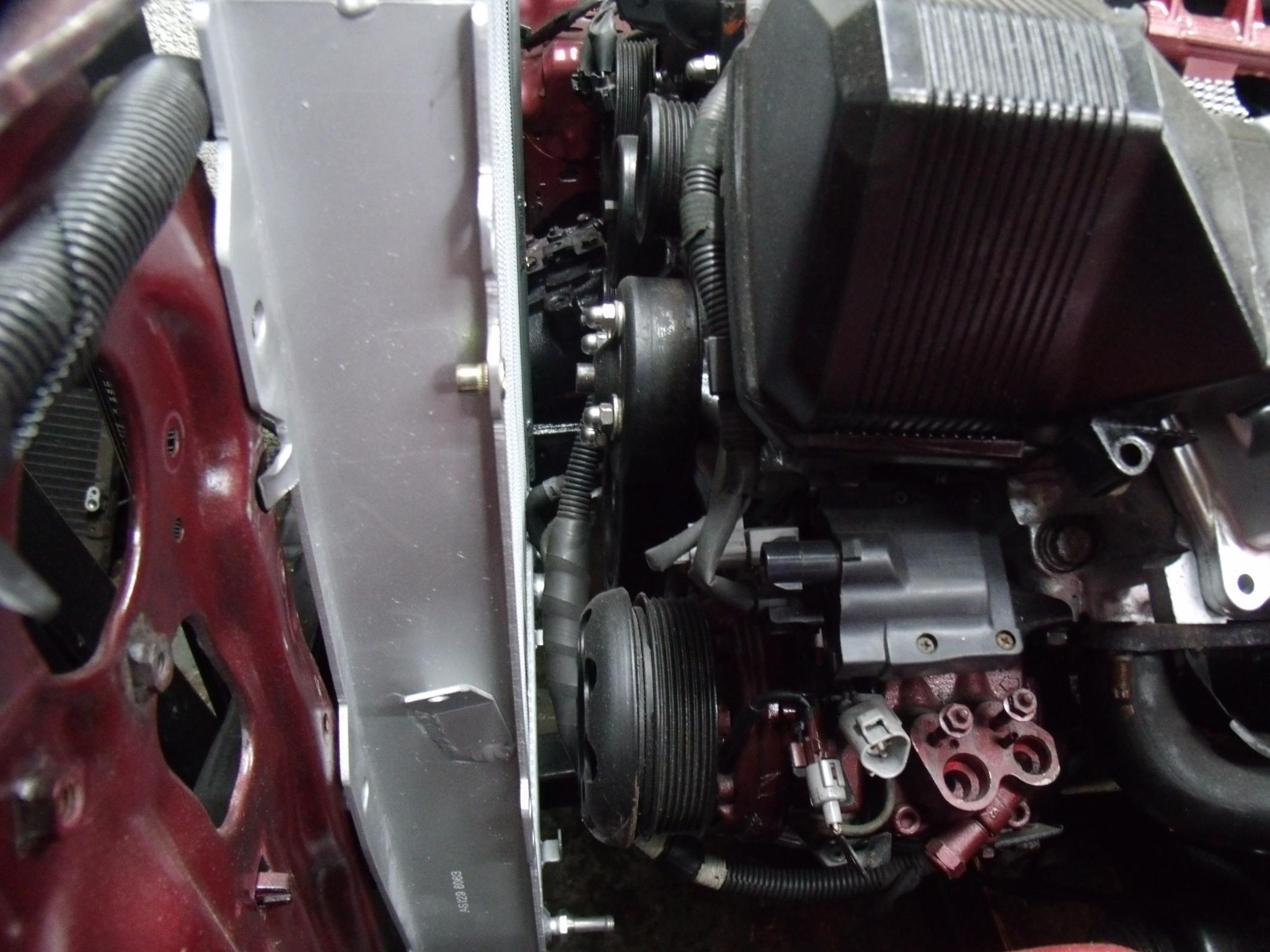

              • #97
                Originally posted by Sylux View Post
                Excuse my ignorance, Vince, but...I'm presuming once you remove the stock fan from the engine (to use the electric one) you'll be left with the various and unnecessary parts that would accommodate the original fan, like bolts or nuts sticking through the pulley?
                Yet when I look at conversions I see very neat solutions.
                Or am I being a complete idiot and it's just a case of removing the unneeded fan mounting bolts etc?
                The Lextreme link you posted refers to the hydraulic fan thats fitted to Celsiors and most Soarers. The fan assembly on those cars have their own fluid reservoir and operate via a coolant temperature sensor.
                For the rest of us, just seperate the pulley from the vicous fan, and refit the pulley and the nuts with some thick washers to take up the thickness of the now missing viscous fan's flange.
                See below.....
                • #98
                  There you go...that's what I was after
                  Cheers, boss
