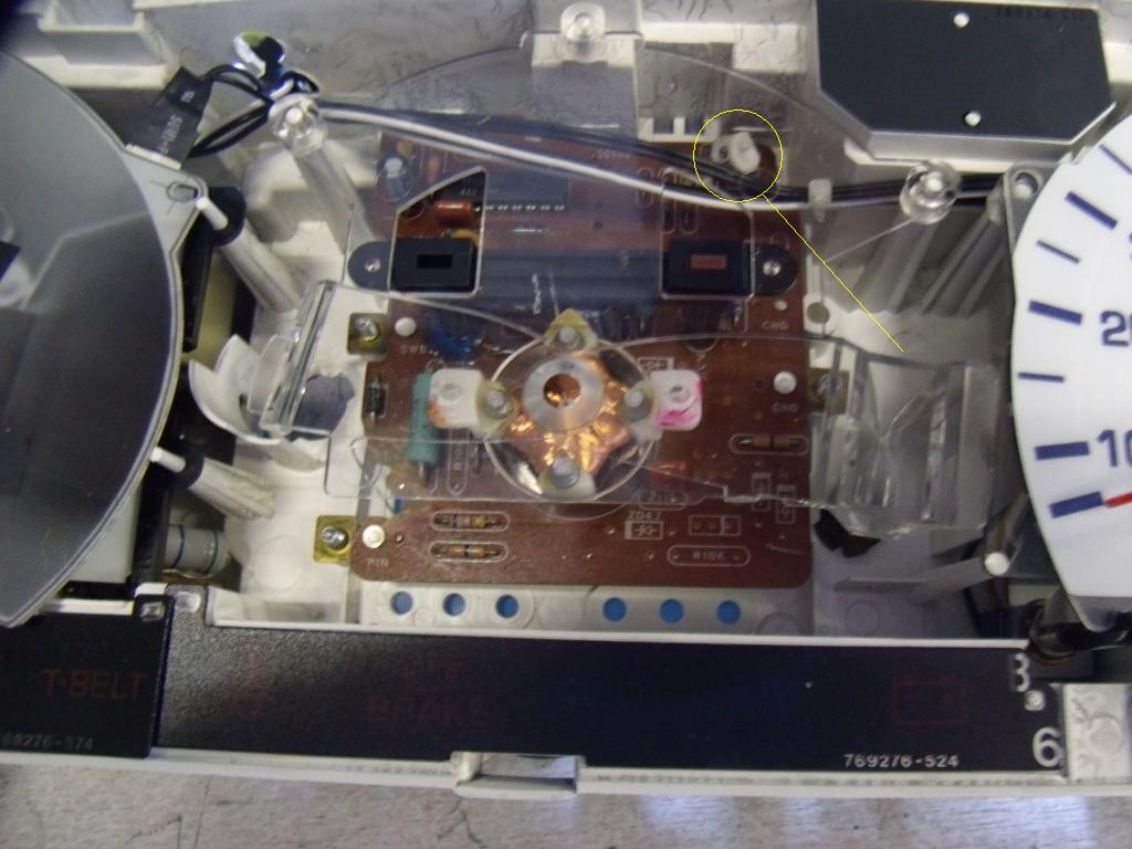

                • Originally posted by zem_41 View Post
                  It seems to tick over at 250 rpm too or just below, is this normal? Doesn't cut out though
                  It'll read low as the tacho is calibrated for a diesel engine. There is a potentiometer that can be adjusted, just turn it fully clockwise....
