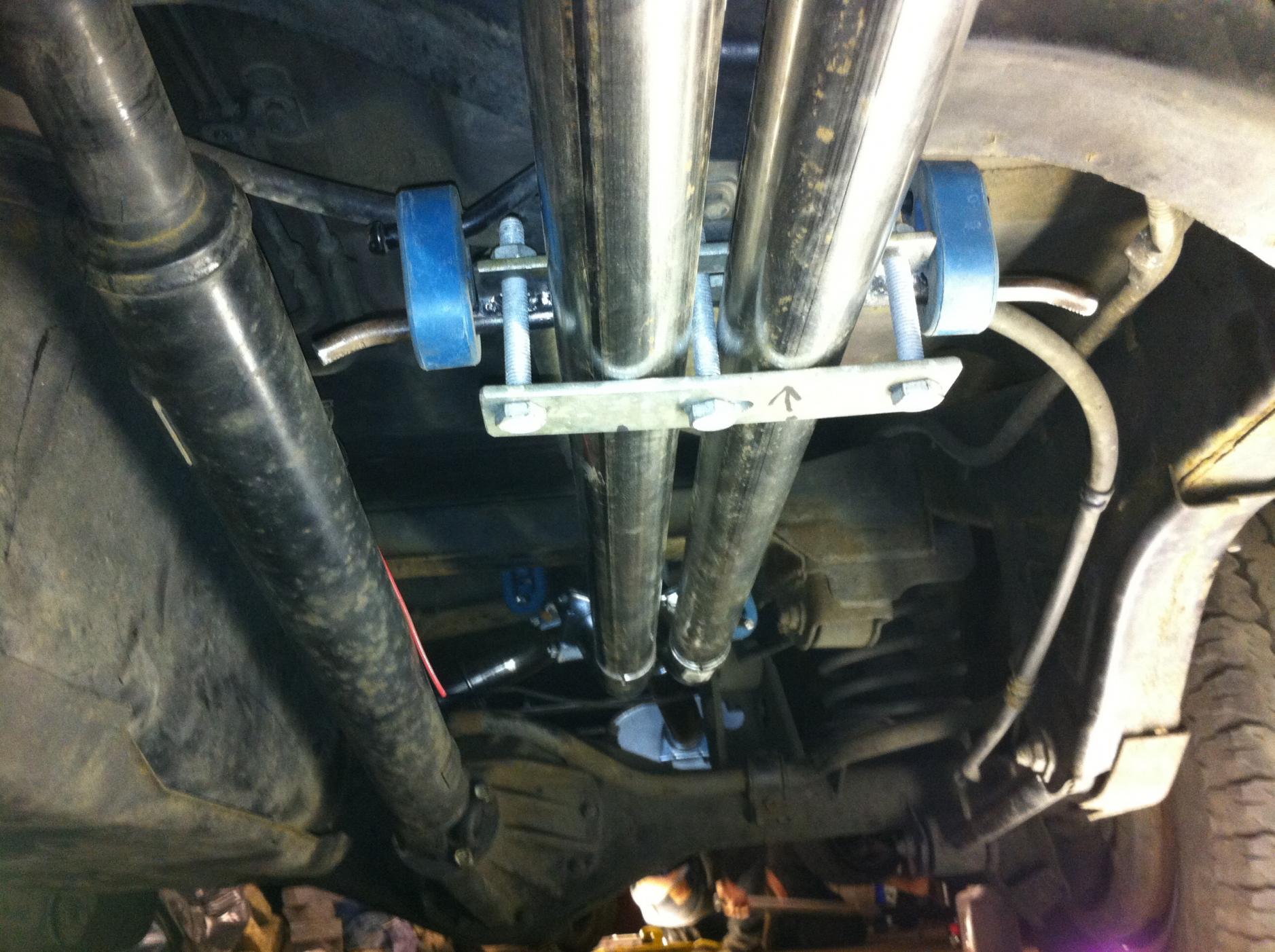

Been a busy few days, the engine is in and all bolted together, the tank is in, the prop shafts are in, the exhausts are done, gear selector needed extending by 25mm so that's done, got wires to the fuel pump ready, got the oil temp and pressure sensors tapped into the soarer oil filter housing, got the water temp sensor tapped in. Had an issue with the gearbox as when I bolted it together a weld on the flywheel lined up exactly with one of the threaded plates on the torque converter and locked it up so had to slide the box back off to find this problem, what are the odds! Made a filter holder out of the lexus bumper and installed the fuel lines to the filter, brakes are done. The vlovo fan I got off eBay for £7 turned out to b a sucker so I couldn't use it on the rad so I mounted it on the removeable tray underneath so it sucks up cold air from underneath no photos yet as it's still wet. So nearly there but unable to continue as I have no loom:-(
Here's a few photos on where I am.
