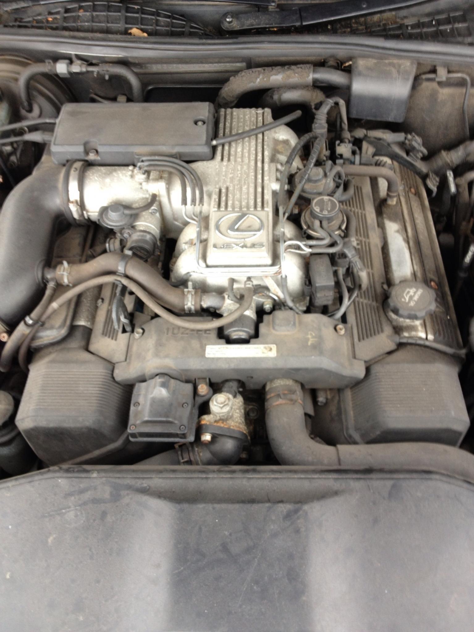

                Went to pick up the lexus. Damn roadworks on m6!!
                Left at 5, should have been a 3.5 hour journey at that time. But noo. Roadworks made it a 5.5 hour journey. Stopped for 5 minutes at the nice mans house who sold me it then a brisk 2.5 hour journey home. My mate, the Lexus driver said engine is great. Brakes are shocking. Brake hard and the back end steps out so I'm presuming axle bushes are away. Shame.

                            Lifting the engine out of the surf tomorrow night. I am just wondering if I can lift the engine and box out together, without cutting the slam panel? It's being done outside by a forklift so height isn't an issue, just trying to prepare myself for unexpected problems.
