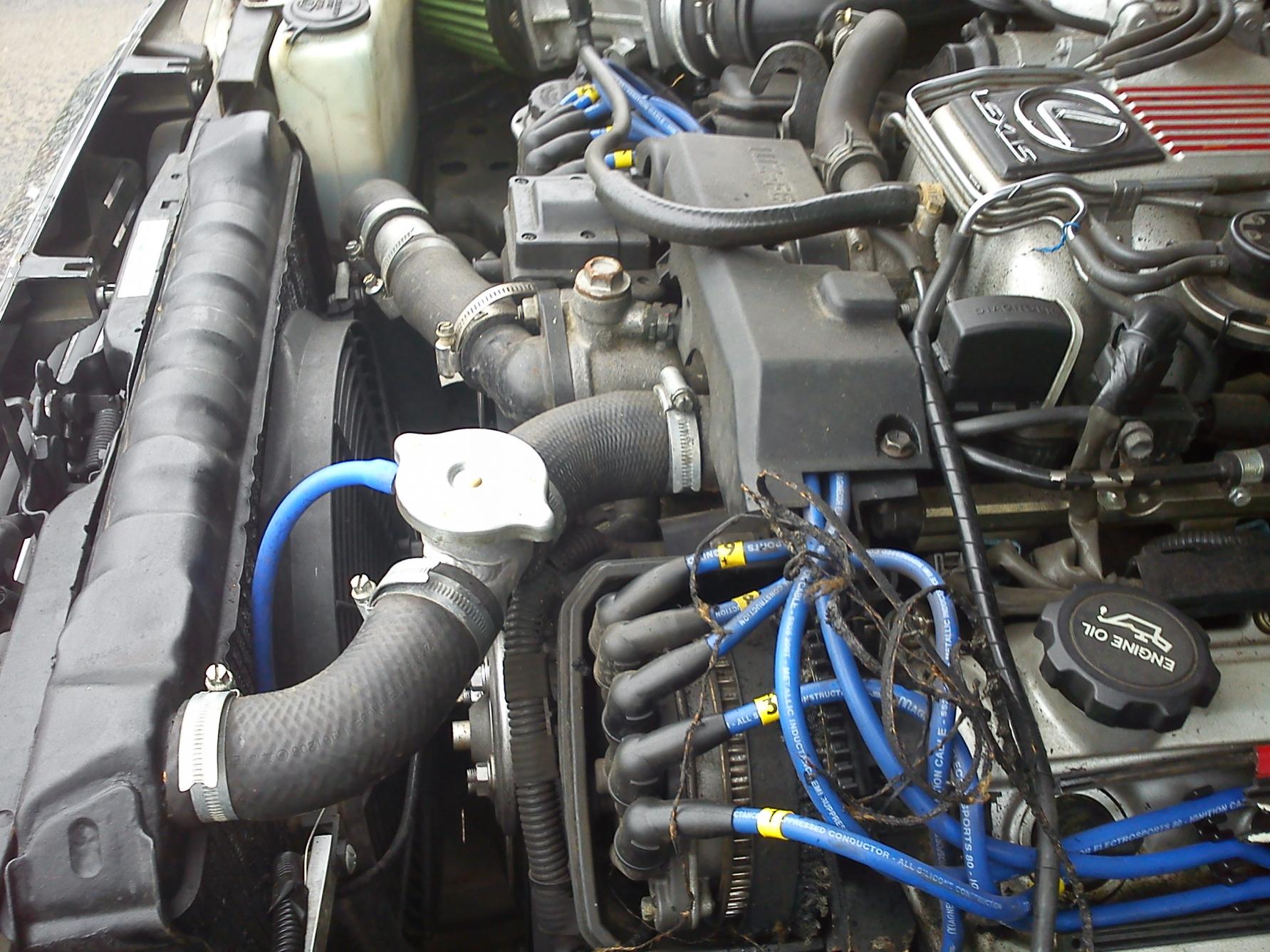

the belt gave way on Lexurf III's LS engine the other week , i had been pushing it a bit, but it turned out the problem was caused by the waterpump or tensioner bearing packing up and seizing, when we stripped the front out of the block there were steel ballbearings melted to parts of belt....
I followed vince's advice to order a waterpump kit from USA cost £265 (thats inc the tax), same parts from UK lexus direct were £462. Add to that the fact i ordered the parts on Tuesday and they arrived Friday morning the same week, I call that top service. Pump and belt are back on and she's running ok. It wasn't that hard a job, just remembering where everything goes back on was the hard part..
